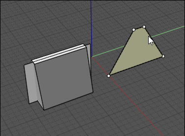

Hello, is there way to scale only face?
Let's say that I change my mind and i want to scale only the upper face inside, like the second object.
How to do that?
Thank you.
Robert.
11067.2 In reply to 11067.1
If it's a "primitive"
Show Points
Select them and scale them!

11067.3
Else more tricky for any volumes using the Flow Function!(2 steps here)
EDITED: 18 Apr 2023 by PILOU

 From:  Robert (ROBERT_S)
11067.5
Thank you, this is excellent.
11067.6
I need ask to one more question.
How i can make edge loop, i need extrude only that half of that face.
11067.7 In reply to 11067.6
Hi Robert,
Draw in a line across the face, select the face and run Edit > Trim. At the prompt to select cutting objects select the line and push Done or right click in a viewport. At the next prompt to select which pieces to discard press Done or right click in a viewport to leave all pieces behind.
That should trim the face into 2 faces, select the half you want and then run Construct > Extrude.
11067.9 In reply to 11067.7
Yeah, that's it.
Thank you guys, youre the best. : )
11067.10 In reply to 11067.9
Don't forget to kill the line cutting...after trimming...if no need...
(or enable Delete Cutting Objects) in the Trim function
