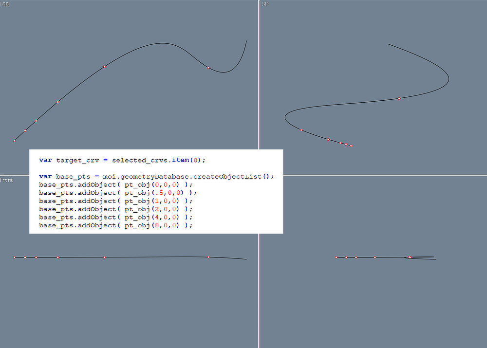

10519.2 In reply to 10519.1
Hi Ed, here is an example script command that uses flow to map some points from an internally defined line onto a selected curve. Hope that is what you were looking for.
10519.3
Thanks Michael - That's perfect! I can work with this.
Just define and add base.pts as required.
