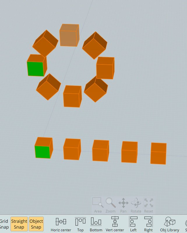

Make a cube and assign a Style to one face. Any of the Array variants will show the assigned style on the copies, until you release the mouse button.

Hi Ed, here is how it behaves over here:
Do you possibly have
[Styles]
DisableSubObjectStyles=y
set in moi.ini ?

Thanks Michael,
Yes - I had DisableSubObjectStyles=y because I prefer boolean operations to make a single style result.
Guess I'll have to decide which setting is more important for my usage.
