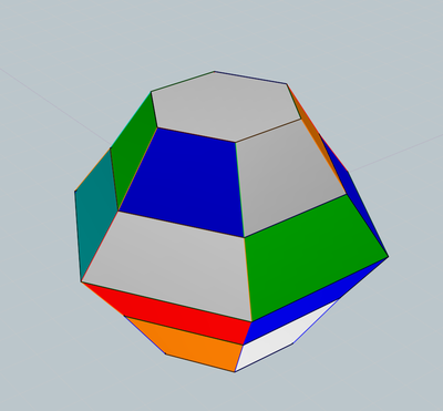

Thanks Michael!
Tested here using first 6 default colors in Styles list.
script: /* Assign random styles to faces and edges */ var styles = moi.geometryDatabase.getObjectStyles(); var breps = moi.geometryDatabase.getObjects().getBReps(); for ( var i = 0; i < breps.length; ++i )
{ var brep = breps.item(i); var edges = brep.getEdges(); for ( var j = 0; j < edges.length; ++j ) { edges.item(j).styleIndex = Math.floor(Math.random() * 6); } var faces = brep.getFaces();
for ( var j = 0; j < faces.length; ++j ) { faces.item(j).styleIndex = Math.floor(Math.random() * 6); } }
