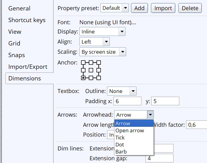

9942.52
Needed to indicate direction of rotation.
Didn't find a suitable arrow in the DIMs section.
Am I mistaken? Otherwise, might it be useful to add some arrows?

9942.56 In reply to 9942.53
Thank you Pilou,
I was interested in an arrow that is NOT in the context of a dimension.
For instance, on the angular dimension... one can blank out the text, but still I don't see how how to suppress one of the arrow heads nor the dim lines.
Sometimes, one might want just a single headed arrow.
Perhaps I am missing the conclusion...?

9942.58 In reply to 9942.52
So can the option for a null arrowhead be added by Michael, in addition to options for e.g. a barb or dot or open arrowhead...?
Either or both arrowheads being null?
Add option to dimAngle factory for not displayiing angle numbers?
New question: The result of the dimAngle looks line a drawn archery bow, with the string being two lines. Are the two lines needed,
or can there be an option to not show the two lines?
The drawn bow seems to be one object, some type of object. It cannot be separated? Nor portions deleted?

9942.59 In reply to 9942.58
You can draw arrow call outs "leader" with the dimension tool and leave the text "blank"
[AFTER you draw the leader arrow and the text box appears just CLICK OK].
I used this earlier to label a tiny rebate that was less than 2mm to draw attention to the
Design detail for a fabricator..
Tip:
1. Try/consider using LEADER arrow and "abc" text separately. It seems really flexible!
You can also put more points than needed on the arrow part then later "show points"
to give even more flexibility on the arrow direction and placement.
UPDATE:
2. Create presets for different arrow types.
>> Options/Dimensions/Property Presets & "ADD"
Focus on the arrow section..and "ADD" preset.
Then when you draw leader arrows and RIGHT CLICK you can see the presets
and swap them about at a click.
I'm not sure this is it's full intended use but it's rather flexible. If you leave text
out and have extra control points shown then the 'arrow' is effectively totally separate
(and sizeable or pivotable in lots of directions). Text can be added at any time
through 'leader details' or via separate "abc" text tool.
