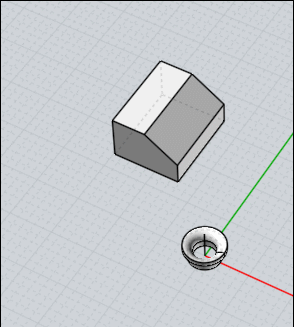

Hi Michael - many thanks for revolving my head onto a simple outline to cylinder shape
function with REVOLVE. The contour was done manually (top view trace) in MOI3D and i think i got
the points pretty 'spot on'. I do have other ideas for getting outlines; more on that later.

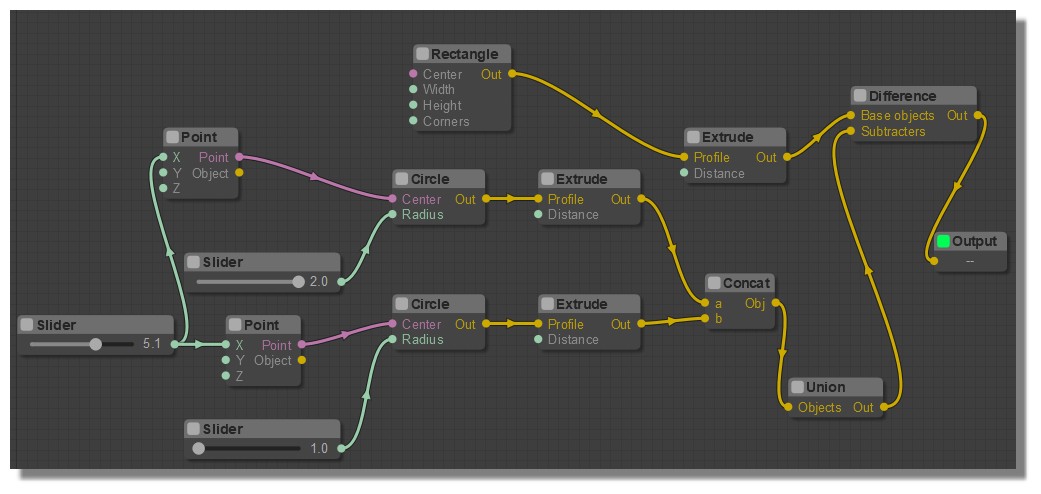

Another method of creating a counterbore with the Node Editor.
EDITED: 17 Jan 2021 by WAYNEHILL5202
9929.23 In reply to 9929.22
...and the image of the code Nodes above for give ideas! ;)
 From:  stefano (LIGHTWAVE)
9929.24 In reply to 9929.22
Hi Wayne, that looks nice and powerful must test this later - time permitting! BR Stefano.

Hi Ed, I am almost expert at revolving plug type fixings now :0)
I do like this mcad approach below, kinda what I explained before. ..
It's its from Ironcad, oops dont like its price...
it's like create part, save it in 'library' (or object layer¿), apply holes to selected surface / hole position(s)...
This is sort of tidy interface works but even a list of variables would be workable and cover basic hole types.
Well documented here:
http://www.ironcad.it/en/manuale/holes
Just ideas or doable?
Stefano
