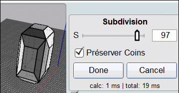

the 2 methods of direct importation from a Zbrush Mini file OBJ
Funny result with the _subdiv_beta9 of Max Smirnov !

9839.25 In reply to 9839.23
"Funny result"
Looks like the faces weren't joined, so it subdivided each face individually...
Pretty cool look.
Pointillism
9839.26 In reply to 9839.25
Yes, it's just the option inside the SUbdivision when volume has not faces welded! (so separated)
Your can permit or not the SUbdivision...(preserve corners enabled or not)
