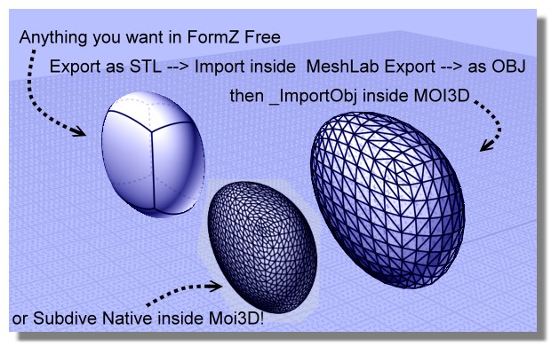

9713.29
<< Edit subdivision of Formz
Minutes 11.00... FormZ Free is free! ;) So can be a cool companion tool before more subDive native Moi3D Edition functions! ;)
So some tricky but... ;) ( _importObj by Max Smirnov)
EDITED: 8 Mar 2020 by PILOU
