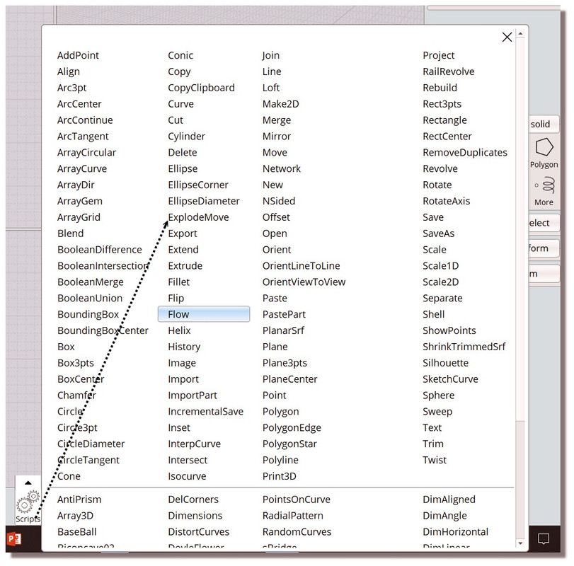

Always fun :) And thx to Max Smirnov for its incredible Subdivision, Split, Bridge, Scale !
Explode Move an Hidden Function By Michael

What is the Hidden Function script?
9676.77 In reply to 9676.76
The hidden function is "ExplodeMove" native you must Press Tab and write it (with any capitals (so EXplodeMOVe is valid) but without Spaces! ;)
You can also make a shortCut
And it's present also if you have installted the List Scripts/Commands helper...for me the more speedy trick! ;)

9676.78
ExplodeMove is in Max's CustomUI, at the top of his Scripts menu.
