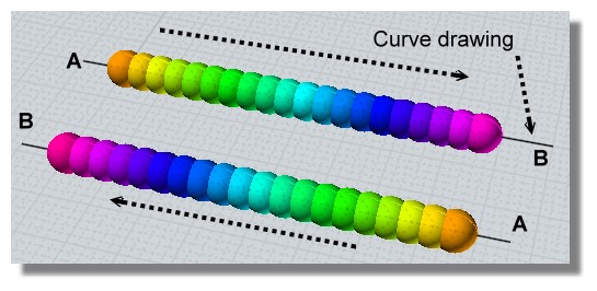

It is assigned by taking the center of the object's bounding box and then finding the closest point on the path curve to that center point.
Then the parameter value of that point along the curve becomes the parameter for the gradient, with the start of the curve being the start color, blending up to the end of the curve being the end color.

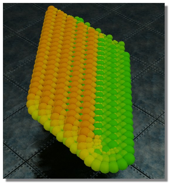

Working on a loxodrome sphere. :-)
loxodrome
The gradient script is awesome!!!

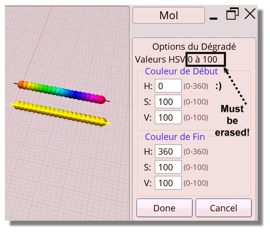

9676.67 In reply to 9676.63
Hi Stefan, I've updated the attached versions to take a hue value between 0 and 360 so you can use these ones without doing any converting.

French version will be done in a few time! (I must go to eat :)
@ Michael : Just a little detail :)
with the new 360 option you must erase this internal rectangle in the English "360" original! ;)
