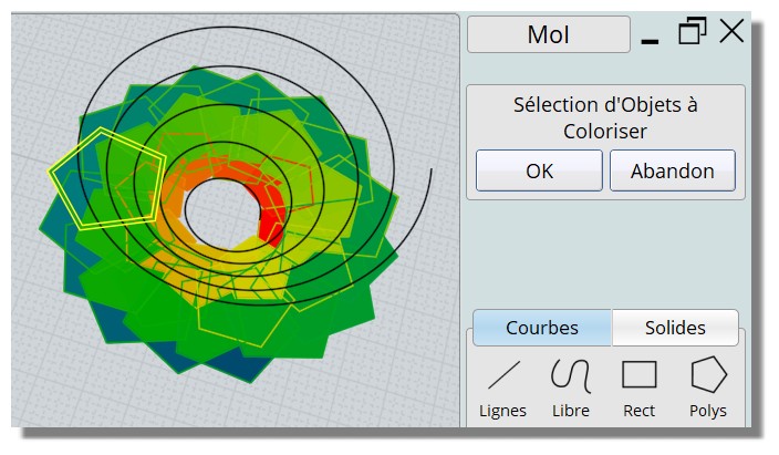

For automatic Mandalas
Make any close curves intercrossed
Select All Transform / Planar
Boolean Merge
= each surface are separated so cool for colorisation!
And French Version of the CreateGradientStylesAlongPath ;)
http://moiscript.weebly.com/uploads/3/9/3/8/3938813/creategradientstylesalongpath_vf.zip
http://moiscript.weebly.com/deacutegradeacutes.html
EDITED: 11 Feb 2020 by PILOU

9676.43
a little quick and easy test, but you get the idea.
quick-gradient-test
9676.44 In reply to 9676.43
Yep but now totally useless with the last opus of Michael! ;)
and no need to give names! ;)
That's Magic!
Of course curves, edges... can be hidden folowing result wanted...

@ Michael How gradient numbers colors itselve are made following the path ?
Following the number of objects selected or following an arbitrary number (eg 100) ?

9676.52 In reply to 9676.46
It is assigned by taking the center of the object's bounding box and then finding the closest point on the path curve to that center point.
Then the parameter value of that point along the curve becomes the parameter for the gradient, with the start of the curve being the start color, blending up to the end of the curve being the end color.
