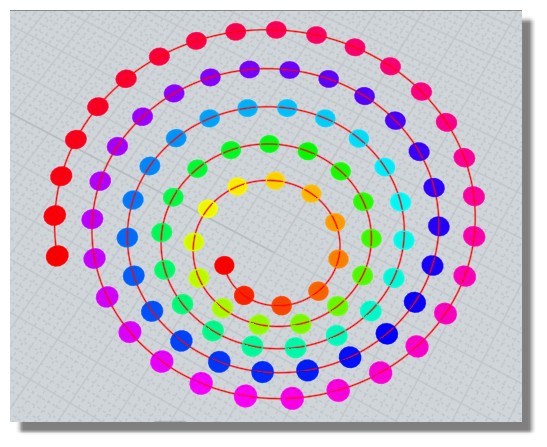

a little quick and easy test, but you get the idea.
quick-gradient-test
9676.44 In reply to 9676.43
Yep but now totally useless with the last opus of Michael! ;)
and no need to give names! ;)
That's Magic!

Little bug for CreateGradientStyleAlongPath
I wanted to see what was the result for only one object selected! :) If it will be start color or end color...
My object is a simple Sweep

9676.52 In reply to 9676.46
> @ Michael How gradient numbers colors itselve are made following the path ?
> Following the number of objects selected or following an arbitrary number (eg 100) ?
It is assigned by taking the center of the object's bounding box and then finding the closest point on the path curve to that center point.
Then the parameter value of that point along the curve becomes the parameter for the gradient, with the start of the curve being the start color, blending up to the end of the curve being the end color.
