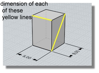

9526.13
Can we make dimension in the 3D view ?
What is the strategy ?
Can you make a little video about dimension in the 3D view ?
For top one I can draw it on the ground then move it...
For the diagonal it's easy in using the other views but...directly in the 3D view full screen?
Ok no problem in using Cplan one for the diagonal, one for top one :)
That works fine but maybe that is not the good strategy ?
It's curious that dimension can't works directly in the normal 3D world for any face! :)

9526.16 In reply to 9526.13
Hi Pilou,
re:
Well dimensions are focused on making a measurement in a 2D projected view. They are planar objects and when you create them they are projected onto the view's construction plane. You can make them in the 3D view, they are just projected down to the the 3D view's construction plane.
If you want that plane to be somewhere else you can use View > CPlane to set the construction plane to one of your box's faces before you create the dimension.
9526.17 In reply to 9526.16
:) It's that I have found! But believed that was another tricky thing ...
Because using the Cplan is not so easy for novice...
In the normal 3D view you can rotate the line of arrow before the second Click...
...it's a little perturbating to not can Click it on Z altitude!
A simple line yes! :) Understand that can be a little frustration :)

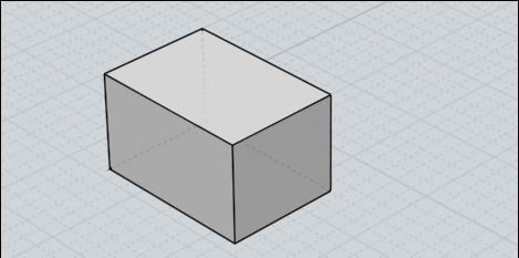

9526.24 In reply to 9526.13
Hi Pilou,
re:
It's kind of dangerous for dimensions to be too easily placed in 3D because it can cause ambiguity.
Like for example when you see a drawing like this:
It's important that it should be a measurement of this length:
And not this one which appears the same in the 2D drawing:
So for the purposes of making 2D drawings it's good for dimensions to be placed with some care and it's not great to try to make it really easy to stick anywhere in 3D space even though that would be fun for playing around with them.
