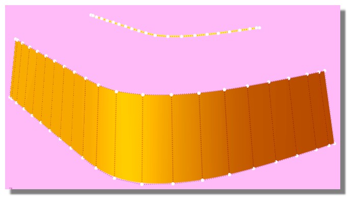

Hi Curious, another thing which is probably getting in the way is that your objects are of a fairly large numeric scale and located a fair distance away from the origin.
Some of your strained surfaces are probably the result of some operation in MoI targeting a fitting tolerance of 0.001 units for the calculated result. When your objects are say 8000 units across that's really small in proportion to your object and that's probably why you've ended up with a heavy surface there.
It's better to keep your objects more around say 200 or so units across and positioned near the 0,0,0 origin point instead of a far distance away.
I've been on an ongoing process to try and make fitting tolerances relative to the object size instead of only fixed at 0.001 units to help with this but you're probably running across something that has not been converted to relative tolerances and your object size and position away from the origin are unusual so it's best not to do that. That's probably adding some difficulty to things.

>> How was that surface constructed exactly? I see some curves in there which do not look super dense like the surface. But there seem to be some duplicates stacked up on top of each other.
The surface was constructed by lofting those blue non-dense curves. It has actually happened regularly that when lofting simple non dense curves the geometry has become dense. Must be somethign I am doing wrong while lofting etc?
Her for example I selected the 2 blue curves and just hit loft, the resulting geometry is super dense!

So the density in something like that is coming from a rebuild step built into Loft. Those particular curves don't seem to be in your previous model file, can you post them?
Density is not exactly something that has to be avoided at all costs, if it's dense but high quality like no little bumps and ripples that can actually be ok.
> So if I am working on a concept object that is 340cm in length. Should I be modeling it
> in 1/10th scale, so 34cm in length?
I probably would do that, but 340 should generally be ok. But sort of from the way that floating point numbers work each jump in size or even position away from the origin sacrifices some small amount of precision in calculations. That's kind of a separate issue from too tight fitting tolerances though.

If you rebuild the curve before Loft you will have a very regular curve with a minimum of Control points!

Hi Curious, re:
Even with the new file I can't seem to reproduce this screenshot above, I don't see the upper curve. I've got these ones:
But the one in your screenshot seems to have points here for example which I can't find:
Over here lofting the curves from those files doesn't make a dense surface:
But if they get rebuilt then they seem unusually dense. I don't really see anything wrong with them so I'm not sure why yet, I'll investigate it some more tomorrow after the new v4 beta release. The current v4 beta is going to expire in just a couple of days so I've got to get a new one put out today.
