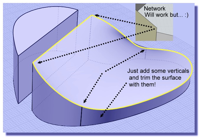

Maybe it's not that you want so don't hesitate to explicite more !:)
Extrude + Trim must make the trick...
I don't seen that you want flat thing...but if it's just for trim Extrude is sufficient
You can of course take a direction of the Extrude if you want...
You can also make Projection by your curve but the extrude is more illustrative and generally
it's better to make trim or Boolean Diff with surfaces than only curves in complex forms... :)
Ps when you send a file of objects better to put them on the middle of the grid than faraway on the 3D Space! :)

Or that ? ...
After the trim
Extrude again
Draw a plane by 3 Points
Move it
Boolean Isect
et voilĂ  :)
But don't know if it's that you want! :)
