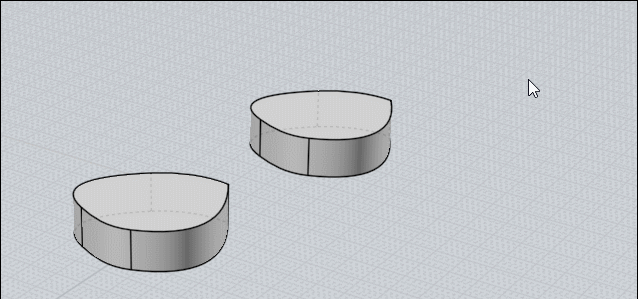

Hi friend, thanks for posting the extrude taper problem file.

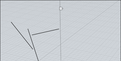

So yes that is caused by your polyline being fragmented into multiple segments. If you use Edit > Separate on it you should see that some of the areas that look like lines are actually 2 individual collinear line segments instead of just one single line:
I've attached a .3dm file where I've fixed those up to be single lines and if you do a tapered extrude on this one you shouldn't see that problem anymore.
I'll see about your fillet questions a little later on.

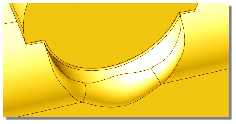

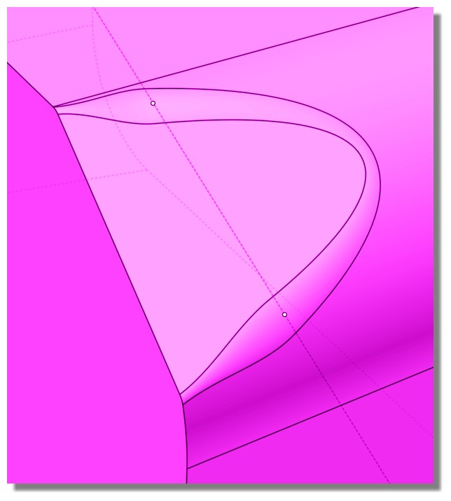

> I think the construction line is preventing the fillet from being larger.
Yes, that's correct that is a limitation in the fillet engine in the geometry library used by MoI.
> What I want to know is: can other programs solve this fillet or is
> this a universal NURBS fillet problem?
It's a pretty common limitation in fillet code that hasn't had say something like a minimum of 50 man years invested in developing it.
The sort of "top shelf" ones like ACIS and Parasolid can handle that one though. But they can also be more finicky about wanting quite precise geometry as well though.

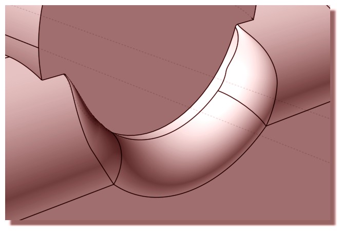

9521.23

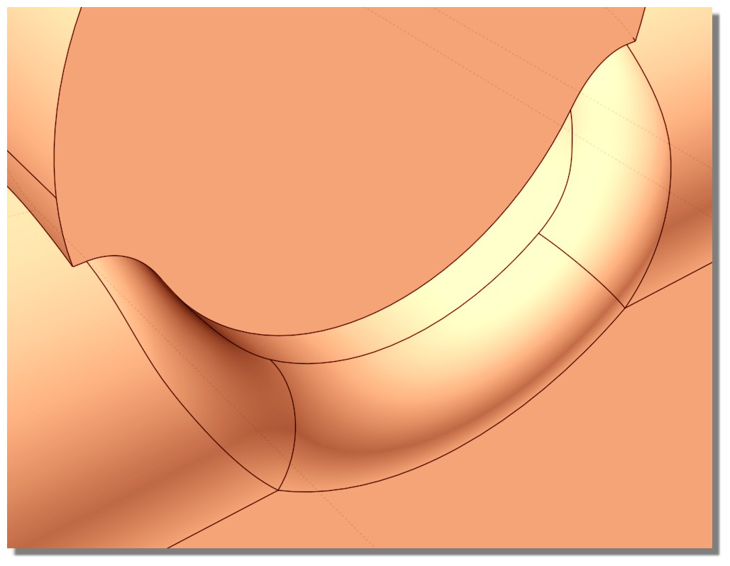

You can make the same in Moi ;)
Just make first avery little fillet like 0.02 as you don't know yet what is working...
Then a Variable fillet 0.2 where you want for test
et voilĂ  !
Seems 0.25 a maximum for a uniform fillet
You can Draw an Helper line(s) during the Variable fillet before the first click for have symetrical things!
Forgotten the top fillet!
In 2 passes : first the top second... new one only the front face...surrely several possibilities...

Frenchy, I have tried to do a variable fillet as you showed but the construction line still gets in the way. Why is the construction line not interfering in your MoI? Do you have some special plugin or did you fix it somehow?

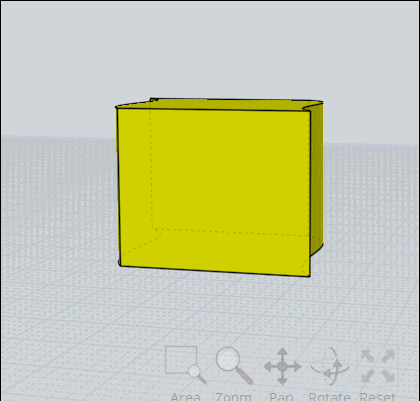

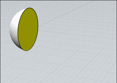

Hello, is there a way to have a tapered extrusion of a curved surfaces? If not, is there an easier and faster way to loft the edges of two curved surfaces than one at a time?
I created a sphere, a curve which I then filleted. I copied and pasted the sphere and used Trim on the copy and selected the curve and got a cut surface. I then made a copy of the surface and scaled it smaller and now I want to loft them together to make a solid and Boolean Difference the sphere.
9521.29 In reply to 9521.28
Where is the 3dm ?
(Vertical is not made her...
EDITED: 19 Oct 2019 by PILOU
9521.30 In reply to 9521.28
Hi friend, the regular Extrude Tapered option only works on planar objects. To speed up your case there though you could use the Construct > Offset > Shell command.
To use that you can skip creating the second surface and the lofting, instead start with just one trimmed surface:
Then run Construct > Offset > Shell and give it a thickness. That will generate an offset surface which for a sphere will be a scaled sphere, and it will do a loft between the edges of the offset and the original for you, giving this result:

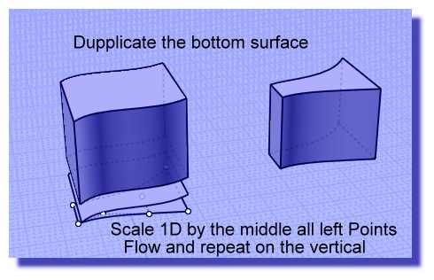

The vertical one (all that will be more easy when a Box deformation will existing! :)
(take all points except the vertical one on the right for make the 1D by the middle)
Normally you will have a sort of tapered volume of the original :)
Maybe there is more tricky but for the moment that is my speedy try! :)

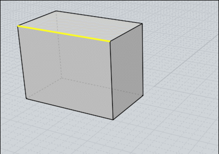

9521.32
In fact seems a Scale 2D Front then 2D Front Right gives a cool result!
Separate the volume so all faces are free
Show Points
Select only all Points on a 3D side (so the principal face don't be changed)
Make a Front Scale 2D from 3D middle center
Make the same value Right Scale 2D from the same 3D middle center
Join all
You have a tapered volume without Box Defomation!
I will com back with the good second scale ;)
because here there is a little error!

Hi friend, it's very helpful if you could please post the .3dm model file of your objects instead of only a screenshot.
For example in this case I would have been able to test with your objects and that may have helped me notice that you wanted a steeper angle result.
So yes Shell produces lofts that are aligned with the surface normals.
If you wanted to do Loft then a quicker way than doing Loft many times would be to use Edit > Join so you had 2 curves which each were made up of 8 segments. Then you can loft between those 2 joined curves. When there are the same number of segments in each curve that will be the equivalent of doing each loft individually between segments.
Another way that might be useful would be to make a planar tapered extrude and then beam that onto your sphere using projective Flow. Position the base plane for the flow a little ways inside the shape so that when it's projected the top surface doesn't try to skim directly along the sphere surface because that then makes for difficult booleans.
So that would look like this:
Create planar curve:
Extrude tapered:
Create base plane for flow positioned like this:
Flow with "Projective" option:
Boolean difference:

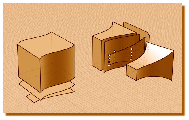

9521.36
A volume with different curves
Diff the part to taper
here I kill the Top / Bottom faces + one face of the no Tapered part (not indispensable - its just for see the internal volume :)
Separate
Show Points for easy selection of points who will "scaled"
Scale 1D on the Height by a middle
Scale 1D on the Width by a middle
NetWork Top / Bottom
Join All
= I have a Solid
Follow 2 "tapered" from different start face
