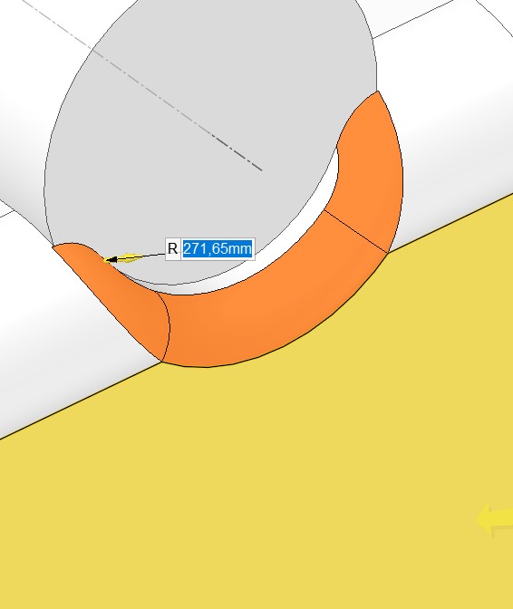

Michael, I attached the file which gives me problems with tapered extrude as "extrude tapered problem".
<<Yes absolutly : Till now Moi's Fillet don't manage that (i tested with Onshape, DesignSparkMechanical, Fusion 360...it's the same)
Do you mean that the fillet systems of those programs also can't do a higher fillet or that they can? I understand that some shapes can give MoI's fillet a hard time, like the example I started this thread with but what about this?
I think the construction line is preventing the fillet from being larger. What I want to know is: can other programs solve this fillet or is this a universal NURBS fillet problem?
I understand that there is a natural limit to fillets because the trim curves intersect each other:
But is there a way to solve a fillet when there is a construction curve in the way? I also uploaded the file for the fillet issue.
9521.20 In reply to 9521.19
Yes they block at the same value!
Designspark block at this form for your last send!
There is no more material ! it's a slope at 90° :)
