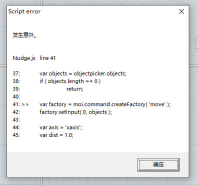

952.34
Script error
Nudge.js line 41
37: var objects = objectpicker.objects;
38: if ( objects.length == 0 )
39: return;
40:
41: >> var factory = moi.command.createFactory( 'move' );
42: factory.setInput( 0, objects );
43:
44: var axis = 'xaxis';
45: var dist = 1.0;
快速移动时报错(Error occurs when moving quickly)

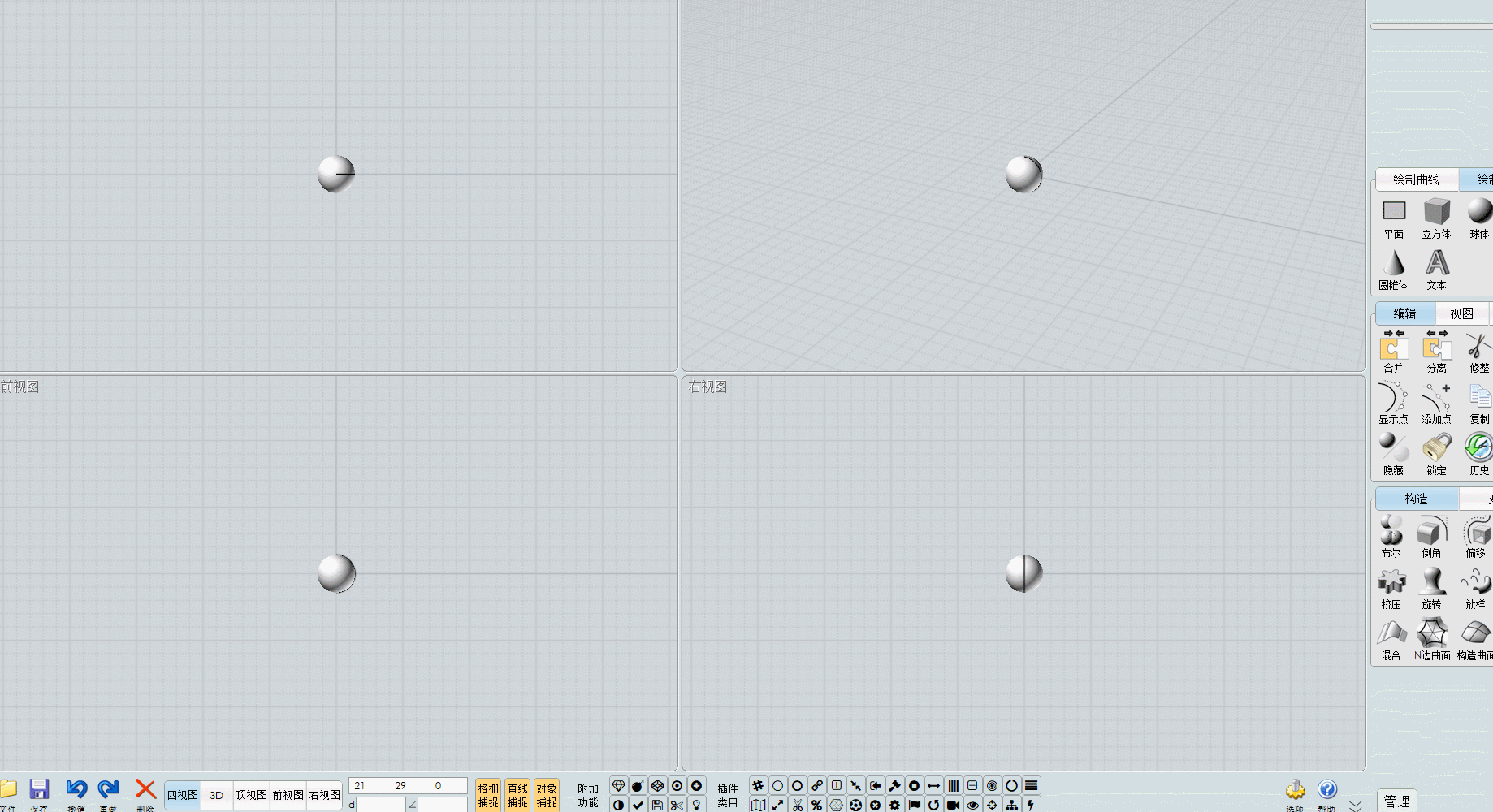

952.36 In reply to 952.35
https://moi3d.com/download/scripts/PetrsMoiPage/PetrsMoiPage.htm#Nudge 这个地址的Nudge.zip和 CPlaneNudge.zip。网友报错,我没能复现这个报错。他使用的是自己弄的带有xml,css的运行脚本按钮的v3版本,我想问,是否有可能是因此造成冲突而报错?(The Nudge.zip and CPlaneNudge.zip files at this address. The netizen reported an error, but I was unable to reproduce it. He was using a v3 version of the UI with some XML and CSS running script buttons that he had created himself. I would like to ask if there is a possibility that this caused a conflict and resulted in the error?)
相应图片上传至图床(Upload the corresponding image to the image hosting service):https://i.imgs.ovh/2026/07/01/bda2ff7c46fdceed0df71032c6c0d94a.png
https://i.imgs.ovh/2026/07/01/c2cb3c43e3dd13a2f005f42338643646.gif
https://i.imgs.ovh/2026/07/01/ae9513e393c72c9496be4a4fa9ef121e.png
因为我不懂代码,所以我对MOI界面的修改都是基于原本样式的按钮,添加或删除相应位置的按钮。他怎么改的我并不懂,所以只是问一下可能的原因。(Since I don't understand code, all the modifications I make to the MOI interface are based on the original styled buttons, adding or deleting buttons at corresponding positions. I don't understand how he made the changes, so I'm just asking about the possible reasons.)
我使用了他发给我的UI包,也没复现这个报错。(I used the UI package he sent me, and I didn't reproduce the error.)
EDITED: 30 Jun by SUIYAN
952.37 In reply to 952.36
Hi SUIYAN, can you ask them what version of v3 they are using?
It's under Help > "About Moi" :
Thanks,
 From:  大道刀 (SUIYAN)
952.38 In reply to 952.37
Version 3.0 Sep-18-2014。
952.39 In reply to 952.38
Hi SUIYAN, is that your version of v3 or the one that is getting the script error?
I think that error could be from a bug in an old beta version of v3 that was fixed in the final release.
So please tell them to make sure they don't have pieces of old v3 beta versions in there.
If they have an unmodified v3, can they test with it and see if they get the script error only in their customized version and not in the standard version?
Thanks, - Michael
