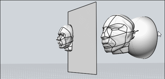

9508.25 In reply to 9508.3
Hi Frenchy,
"Falloff" in Modo has to do the amount of influence you have when you push/pull polygons. Example, look at this image. The bottom bump has a greater "falloff."
Size: 570.2 KB, Downloaded: 30 times, Dimensions: 566x230px
9508.26 In reply to 9508.25
Ah ok a sort of area of influence ! :)
