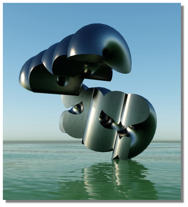

9485.10
Super tricky! Bravo!
EDITED: 6 Sep 2019 by PILOU
