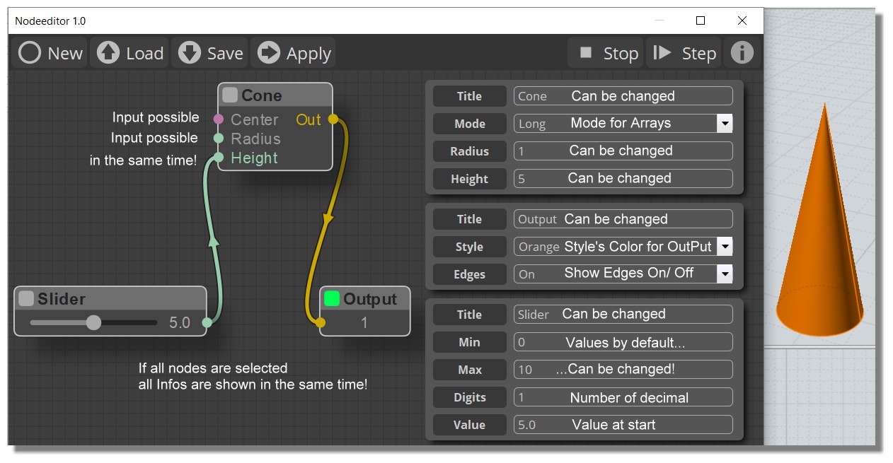

9476.19
Added some cool features! ;)
If you click on the up corner button "New" you can open any number of NodeEditor's Windows !!!
http://moiscript.weebly.com/node.html
If you save your Macro inside the Application Data Macro folder you will have your Macros accessible inside the Macro Pane!
Here named macro 1 etc but you can input any names!
http://moiscript.weebly.com/macro-e.html

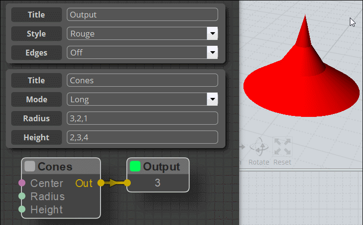

And will correct a little error about Mode for the Circle(as previous node demo example) !
the 3 "modes" Short , Long, Cross are not for decimal precision but for use of Array! :)
(i have no example of the "Cross mode" )
so corrected! :)

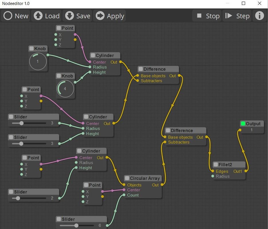

9476.24
Some training for refind the logic of Nodes! Not so trivial :) (and some instability of the not native functions: see next post)
