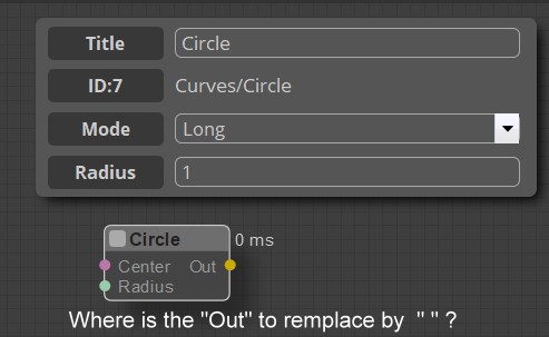

So, for no Macro "out" word: in Macro expanded screen, select output rectangle, and in the info window replace "out" with "type the keyboard space bar" = " "
9476.52 In reply to 9476.51
<< So, for no Macro "out" word: in Macro expanded screen, select output rectangle, and in the info window replace "out" with "type the keyboard space bar" = " "
Where is this ?

9476.55 In reply to 9476.52
Substituting " " for "some output" in a Macro, only applies for a Macro, not a regular node.
Double click on a Macro to expand it, or Right click select Open, in order to see the output "slots" of the macro.
I think "out" for a regular node is hard-coded in the node.js file?
