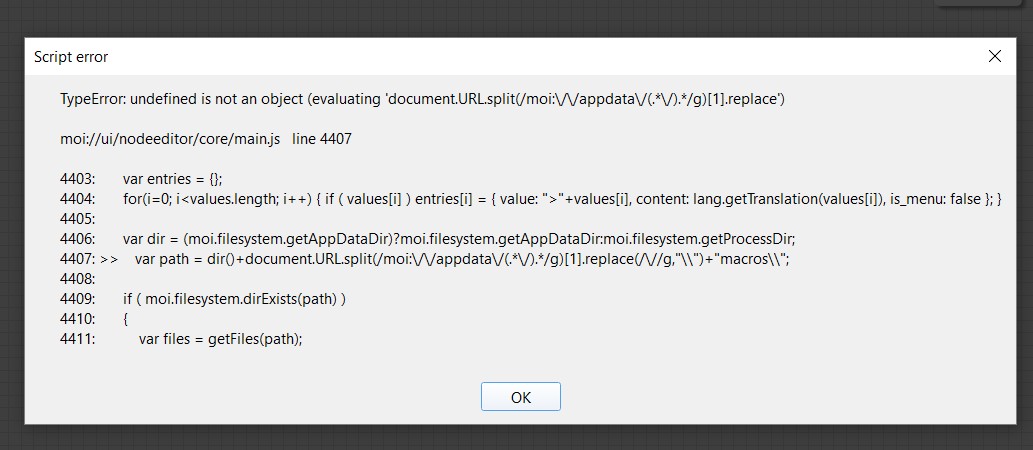

In the V3 I have that all works fine!
Macros don't work in the V4 Beta?
I have that when I press Macro's Button!

9476.4 In reply to 9476.3
Hello Pilou,
this happens if you don't have installed the nodeeditor under the appdata directory.
Hope this helps:-)

9476.6 In reply to 9476.3
Hi Pilou, yes it's a bug in the node editor macro handling where I think it's assuming it is installed in appdata.
But if you edit that line where it is showing the error to give it the correct path I think that should get it to work, see here:
http://moi3d.com/forum/index.php?webtag=MOI&msg=7777.1494

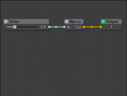

9476.19
Added some cool features! ;)
If you click on the up corner button "New" you can open any number of NodeEditor's Windows !!!
http://moiscript.weebly.com/node.html
If you save your Macro inside the Application Data Macro folder you will have your Macros accessible inside the Macro Pane!
Here named macro 1 etc but you can input any names!
http://moiscript.weebly.com/macro-e.html
