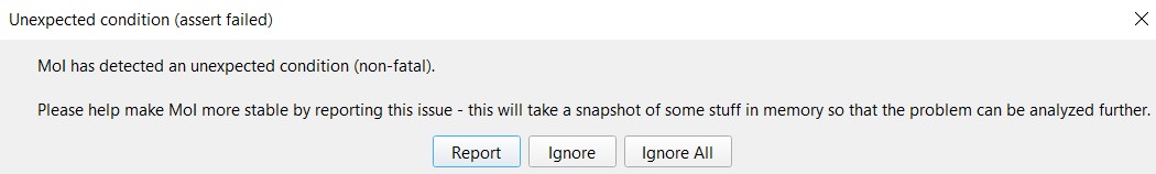

Have you this same error message with this little "nodes" ? (above one)
I have only 8 giga hard memory but don't know if this explain that...

9476.26 In reply to 9476.25
Your node worked here, and made a "donut".
Windows 10, 16GB ram, nod works for either MoI4Beta or MoI3.
(Recent ssd reinstall, with James updates here: http://moi3d.com/forum/messages.php?webtag=MOI&msg=9358.1)

9476.27 In reply to 9476.25
I get the same error message.
I'm on macOS....Are you?
9476.28 In reply to 9476.25
Hi Pilou, if you push the "Report" button does it generate a crash report file? That will be a file named moi_report1.zip . If you get one of those please e-mail it to me at moi@moi3d.com and I'll take a look.

9476.29 In reply to 9476.28
Michael,
When I press "Report" button the error dialog box disappears & immediately reappears but does not generate an error report. Clicking again does the same...& does so for a dozen more clicks.
If then the .nod is STOPped & RUN again (or link to OUTPUT is broken & reconnected) the error
message does not appear.
As I said before, I'm on a Mac.
9476.30 In reply to 9476.29
Hi James, yes sorry the assert crash dump mechanism is not enabled for the Mac version.
9476.31
I am on PC so maybe I will can send the Repport error! :)
9476.32
On what folder exit must be this Repport error ? (seems it's a multiple repport )

9476.34 In reply to 9476.32
Hi Pilou, it would usually be in your temp folder, from the start menu type %temp% and push enter.
9476.35 In reply to 9476.34
Alas seems the "special" report when I press it from these particular Nodes gives nothing in this temp folder !...
9476.36 In reply to 9476.35
Hi Pilou, does everything go ok if you use "Ignore all" ? The next release will have these warnings (called "Release mode asserts") turned off.
9476.37 In reply to 9476.36
Yes all is ok when I press "Ignore" all :) but also can totally exit from MOi without any warning! :) (but not total crashe just Moi)
I believe that rude exit happend when in these particular Nodes above for the no native node function "Fillets" has bad range for the volume considered!
