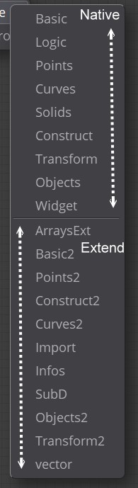

>> And other thing : does the "Native functions" can work only from them ? So making "Orient" just with them...
Actually there are 2 parts of nodes : native and extensions
So i will to know for example if native Orient can be used only with native nodes for obtain an exact results !
Because it was created before the extensions!
Problem for the moment i can't find a simple trick for have the good result!
Difficulties (for me) is transform a selection in a "frame" usable! :)
Orient something following a line or a face...surely trivial but...
Sorry, I don't know the answer to this.
For a curve you could call evaluateTangent on it to get its tangent direction and use that as the z axis of your frame, and you would then need to make the x and y axis directions by doing some vector math like using crossproduct.
If a curve is planar, (crv.isPlanar == true) then you can get the frame of its plane by crv.planarFrame
The next v4 beta will also has that for faces as well.
9476.147 In reply to 9476.146
yes but seems all that is in the "extention" parts!
So stay in stand by till I finish the "native" part :)
