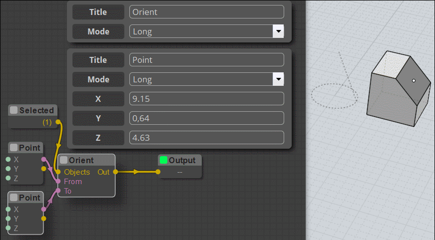

I have some troubles with Orient Node!
Seems no automatic "orientation"! ???
9476.142 In reply to 9476.141
Hi Pilou, I think you'll need to supply a coordinate frame at your desired position instead of just a point.

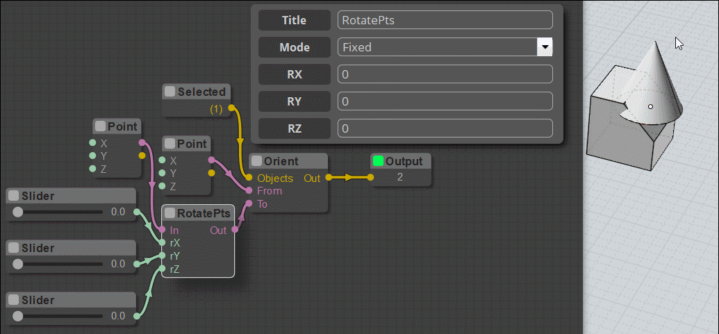

9476.143 In reply to 9476.142
Ok but i don't see difference from a simple "Move" + "Rotate Point" against "Orient" + "Rotate Point" ?
And I must find something who give the exact orientation because with sliders there is not "snap" :)
Something like a "given face" gives the orientation of it...or...
And other thing : does the "Native functions" can work only from them ? So making "Orient" just with them...

9476.144 In reply to 9476.143
Well the regular Transform > Orient command is indeed a combination of movement plus rotation. With something that might have more complex rotations orient could be more convenient. Like if you are applying some kind of repeated rotation on a coordinate frame Orient can take that coordinate frame directly.

9476.145 In reply to 9476.144
Actually there are 2 parts of nodes : native and extensions
So i will to know for example if native Orient can be used only with native nodes for obtain an exact results !
Because it was created before the extensions!
Problem for the moment i can't find a simple trick for have the good result!
Difficulties (for me) is transform a selection in a "frame" usable! :)
Orient something following a line or a face...surely trivial but...

9476.146 In reply to 9476.145
Sorry, I don't know the answer to this.
For a curve you could call evaluateTangent on it to get its tangent direction and use that as the z axis of your frame, and you would then need to make the x and y axis directions by doing some vector math like using crossproduct.
If a curve is planar, (crv.isPlanar == true) then you can get the frame of its plane by crv.planarFrame
The next v4 beta will also has that for faces as well.
