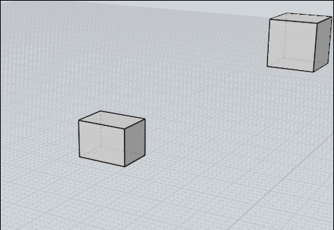

Does this function make something different than the Native Move ?

Hi Pilou, the script move the object only on z axis

Not more powerful with Move + Helpers Lines ?
9411.10 In reply to 9411.9
@Pilou - yes it is possible to use Move + Construction lines to do this type of task currently. This is just a convenient way to do it with fewer steps if you need to do it often.
@moujiik - in the future when I get a chance to do some drawing improvements in MoI I'd like to incorporate some stuff regarding z level in the regular UI. Stuff like show the current selection's z level and maybe set a z level for drawing.

Hi Michael, and Pilou. The script has already save me a lot of time. With a very intricate project, where some objects are deeply hidden and there are a lot of snapping points to chose from, it's very convenient to chose a reference Z point.
I often come up with lines that don't join because of different z level. It happens when drawing from top view, and flatten the whole thing often brings the curve to an unwanted z level. Then the script is usefull to bring the curve to the place we want to make an extrusion.
So, some stuff regarding z level like you describe will probably be a nice adition to the UI.
