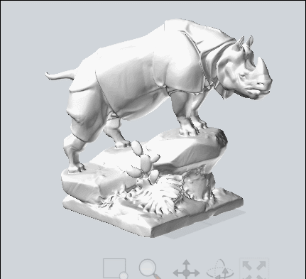

Hi everyone, I wanted to do a conversion test in NURBS surfaces this 3D scan(https://www.thingiverse.com/thing:1415162), I used Blender to generate the square topology with the remesh modifier, then I exported to OBJ and I created a new mesh using a free app Instant_Mesh to generate a smaller file 21.9MB (21.882.962 bytes), finally I imported in Moi3D to generate the NURBS surface from the square mesh obj model, the conversion was successful but the resulting file is huge, unmanageable, to be used too heavy 1.6GB (1.564.648.052 byte)

Hi pafurijaz, thanks for testing it! It is not really expected that such a highly detailed and heavy mesh would give a manageable result, it would need to be significantly simplified for that.
The main focus of the converter is to give a highly accurate result, it's really more intended to enable getting a smooth and accurate conversion from a light sub-d cage so that can be used as a base shape for further NURBS modeling.
Conversion of 3D scanned data really needs a more specialized tool that is focused entirely on that process, it is not a specific focus area of MoI's converter.
That being said it is good to see some "torture testing" of it as well!

try Instant Meshes! (https://igl.ethz.ch/projects/instant-meshes/)
I exported an obj of around 8K polygons, pure quad mesh with a file size of 3.5MB. Imported nicely into Moi3D.
3dm file was around 88MB but it looks clean and i can boolean diff a sphere in 10-15 sec on my MBP :-)
Playing with different polygon counts is easy in Instant Meshes so give it a go!

This is probably because of the relatively high face count in the model. Your model appears to be made up of all triangles instead of being a quad-dominant mesh set up for sub-d smoothing. So because of that you're getting a lot of little tiny faces.
The sub-d importer is primarily focused on converting sub-d models, not non-sub-d triangle mesh models like you are using there.
