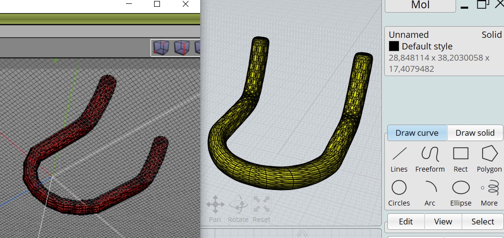

Hi, thanx ... but it runs good - the new SubD fuction - I have made some bevels in a polygon-modeling tool. Thank you so much. But one Polygon-Object I cant load with the SubD Tool. I dont know why, its very simple, no holes, only quads (754 Vertices) ... hmmm I dont know .... created in Silo 2.5.5.
http://www.mediafire.com/file/h04eys1g8e9mtc4/Rohr.obj/file => Rohr.OBJ thats the Missing Part
This OBJ I can also create in moi very easy and fast ... but please tell my, why I cant load.

I'm happy now .. it was my fail - did overwork the tube-ends. Now ist fine ...
https://i.imgur.com/ByHQ19d.jpg

It's because there are errors in the mesh structure, some degenerate faces and some faces with inconsistent normal directions.
The Rhino check command says:
quote:
This is a bad mesh.
Here is what is wrong with this mesh:
Mesh has 4 degenerate faces.
Important things to consider with this mesh:
Mesh has 128 faces with directions different from the mesh as a whole. Although this does not
necessarily mean that the mesh is bad, it can cause problems if you're doing mesh boolean operations with it.
Mesh has 4 pairs of faces that intersect each other. Although this does not
You may be able to fix it by using the "unify normals" tool in Silo:
https://nevercenter.com/silo3d/wiki/index.php?title=Unify_Normals
In the next v4 beta which should be released just later today, the sub-d conversion will skip over the problematic faces and give this result:
