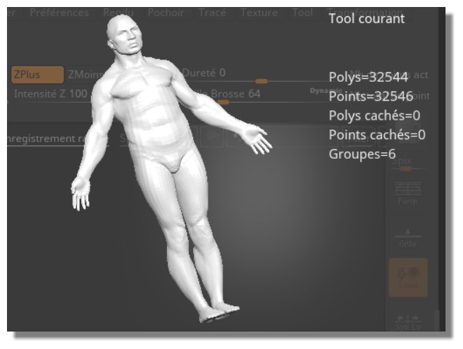

Could you please explain the process you used to prepare the demo soldier as an obj for MoI SubD? How many polygons did you convert it to, and how?
Thank you!
9100.127 In reply to 9100.126
<< explain the process
Hello
Very simple ;) (this object .OBJ is start quadrangulated)
Use the plugin integrated inside ZBrush call Decimation Master : so you can take any number of polygons as result.
1/10 is normally sufficient - 50 000 polys seams reasonnable
If you have not ZBrush take any free prog like MeshLab: http://www.meshlab.net
Menu Filters / Remeshing, Simplification & Reconstruction... for Decimation
menu Filters / Polygonal & Quadmesh... for Quadrangulation
I don't remember the exact number i will remake it so be patient 10 minutes! :)
32 544 polys as result : loading in 18 seconds inside MOI 3.0 (on my latop Windows 10 - I7 4 years old)
(I must verify if it's vertices, edges or faces because it just write number during the process inside moi! ;)
Verified : it's 32 544 polys! ;)
I will put here the file decimated !
So you can load it directly inside Moi with _importObj by Max Smirnov for make your own test! ;)
http://moi.maxsm.net/media/files/
http://moiscript.weebly.com/uploads/3/9/3/8/3938813/demosoldier.obj
(points = vertices)
