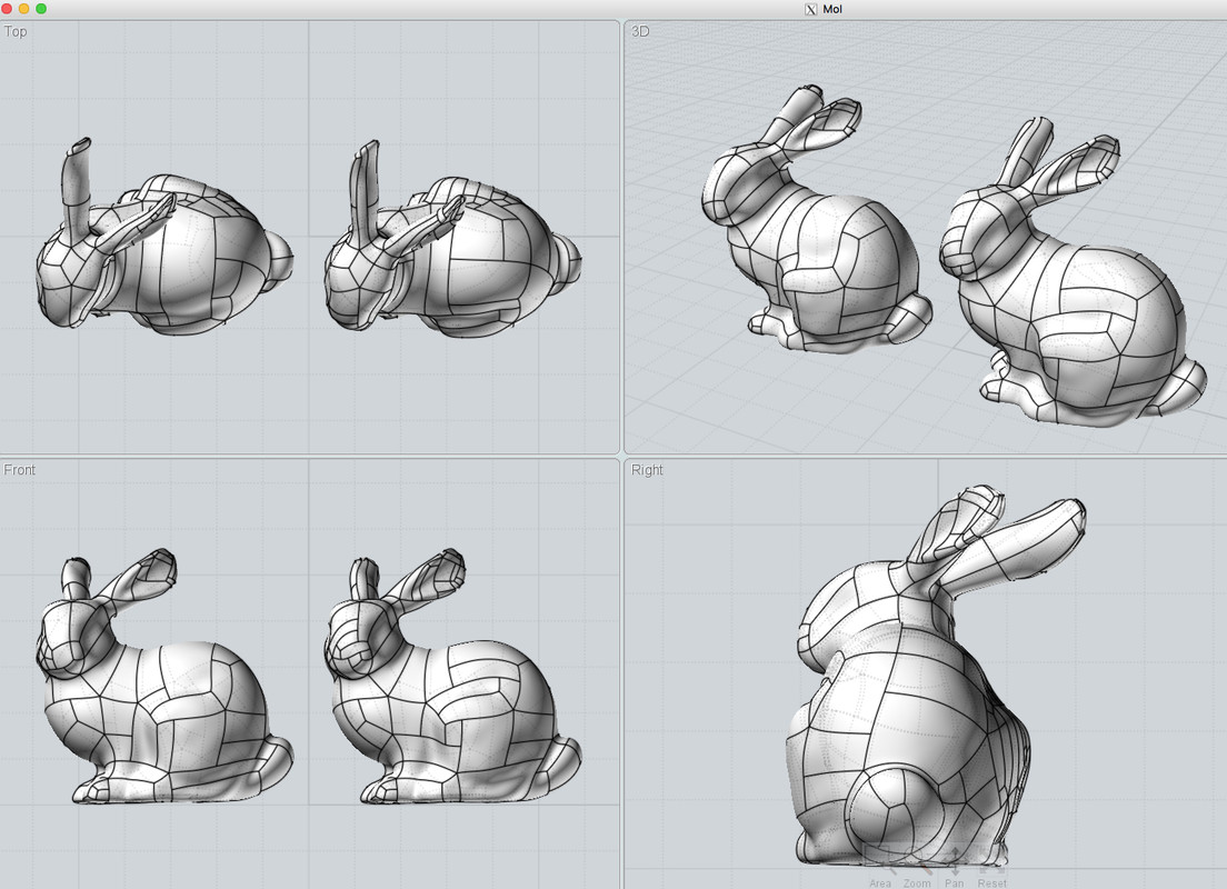

looks fantastic! However i have problems with my very old iMac and my very
small graphics card, so that i show my result in MoIv3.1
Left Bunny from MoI v4 beta 175 patches and unfortunately no solid.
Right Bunny from PowerPack Pro for ViaCAD Pro v10 185 patches and solid.
Best regards
MoIvsPPP
9100.12
O.k. apologies Michael... The bunny from MoI v4 beta is now a solid too, after i scaled him up.

Hi Brian,
maybe you have a very high-res quad mesh? My bunny has only
2333 quads (and no triangles) and was processed in seconds,
on my old iMac.

9100.18 In reply to 9100.12
Hi Stefan, thanks for testing it!
> [EDIT] also after scaling the bunny up the display problems went away when moving the
> model! I should from now on work with the v4 beta, to see if i can find glitches etc!
There seems to be a problem on older iMacs with the new display engine function in v4 that caches display information on the video card.
I've just received an older iMac over here so I can test it and see about fixing that. But for now you can turn off the caching by the setting described here:
http://moi3d.com/forum/index.php?webtag=MOI&msg=9089.7
9100.19 In reply to 9100.12
HI Stefan, also re:
> The original is probably to small for stitching it into a solid.
Can you please post or e-mail me the original unscaled one if you still have it? That is probably something that I can fix up.
