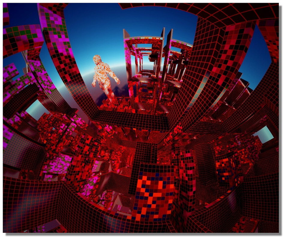

9096.9
Architecture in 30 seconds :D
EDITED: 20 Oct 2018 by PILOU

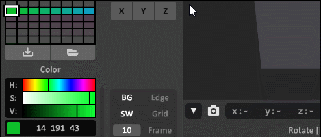

9096.13
When the Moi Object(s) format OBJ...
... is droped by Drag&Drop inside the screen of MagicaVoxel
it's fun to apply to it and other volumes selected random colors from a palett(s)
with the function "rand" on the console (F1) like here: rand 33 40
You can see the number index with mouse over the palett !
Of course it's better when they are existing colors" !!!
The 2 Numbers of index is just start - end color wanted! :)
For make a gradient just SHIFT + ALT with mouse pressed from a color to another (diagonal are permitted)
SHIFT + Move = Copy along the Move
CTRL + Move = Move color
We can save & Load Paletts
With other gradients or colors

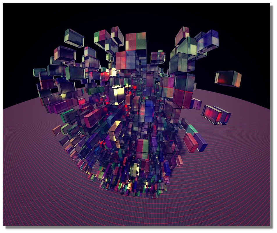

9096.15
in a second!
just write in the Console (F1)
rand 249 10 (take index color palett existing - on the board palett : palett up = 249 - palett down = 8 )
noise 123 0.2 0.3 0.2 (seed scale min max - default values scale =0.03 min = 0.2 max = 0.5)
EDITED: 27 Oct 2018 by PILOU
