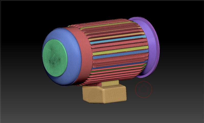

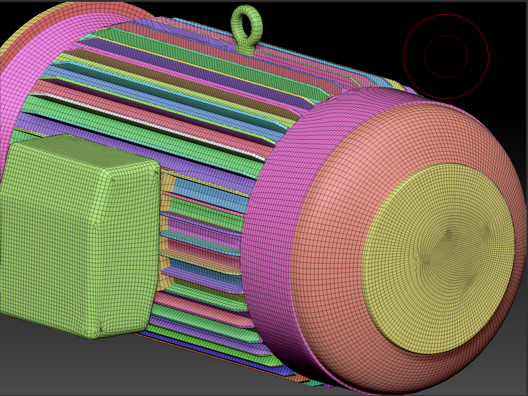

O.k., did a quick and not so much in-depth test.
The first object looks very good, while the second object has
some issues with the small ribs. I may have to check out
better settings, while i must also admit why to remesh such
objects … , when one could either use the .obj files from MoI
or model them directly with ZModeler …
1
2

Hi Stefan, those are some good results!
> I may have to check out better settings, while i must also admit why to remesh such objects …
Well people ask for an "all quads" output from MoI pretty frequently, and these are the kinds of objects where it's difficult to do that (while also being not unusual CAD models as well) so it's a good example of why MoI does not have that function currently.

The original files are NURBS models, saved from MoI as
high-res quad/tries .obj meshes and then brought into
ZBrush for ZRemesher.

Crease / Crease PG borders
KeepGroups & Keep Creases activated
SmoothGroups = 0
a new test must be arrived with a subdivide Larger than 1 unity / All
EDITED: 8 Mar 2019 by PILOU

very interesting. What i have tried now is to use Ngons/Quads, Mesh Angle 5
and then brought the mesh into Silo and applied a triangulation. My thought
was that then ZBrush must not compute so much when doing polygroups
from normals.
Maybe worth a try, because now i have all small ribs clean. In ZBrush i used
then only keep groups and did not use creases / edges feature.
I am sure your friend can archive much better results.
test2
EDITED: 8 Mar 2019 by STEFAN
