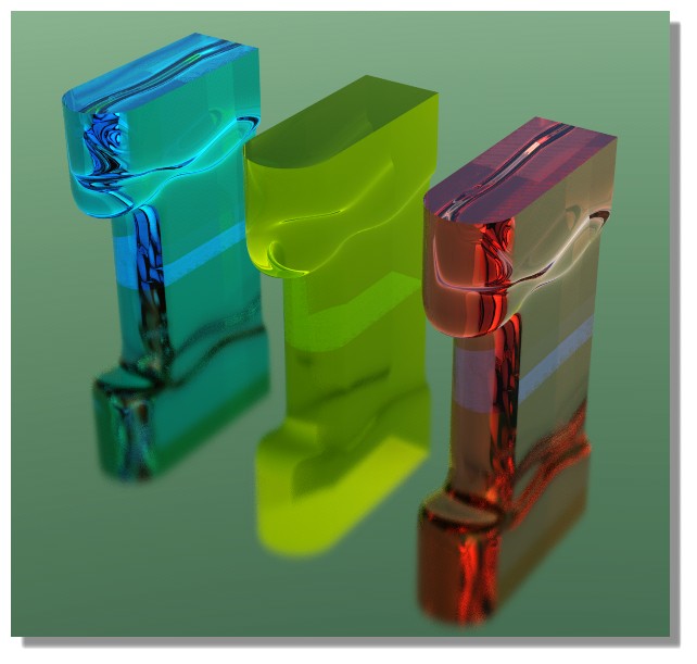

The Blend Function as research of form :)
Draw Curves and Extrude them (or any other transformations for make surfaces )
Select all curves : kill them
You can now use the Blend function :)
Select Edges...Blend them et voilà ...
Any generic transformations (Move, Rotate, Scale of these surface(e) alone or not will be persistant...)
(along you make only generic transformations)
You can of course Show Points of these surfaces and transform these points!
Add Points to these Surfaces breaks the process so Add Points to the surface(s) BEFORE the Blend !!!

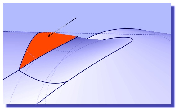

8388.24
merge a sphere with cylinder to obtain curve for fillet
- Tudor -
 From:  Mik (MIKULAS)
8388.25 In reply to 8388.24
Nice! Very useful.
Thanks for sharing.
Mik
8388.26 In reply to 8388.24
Tricky even the orange surface is not more in the straight extention of the tube...
