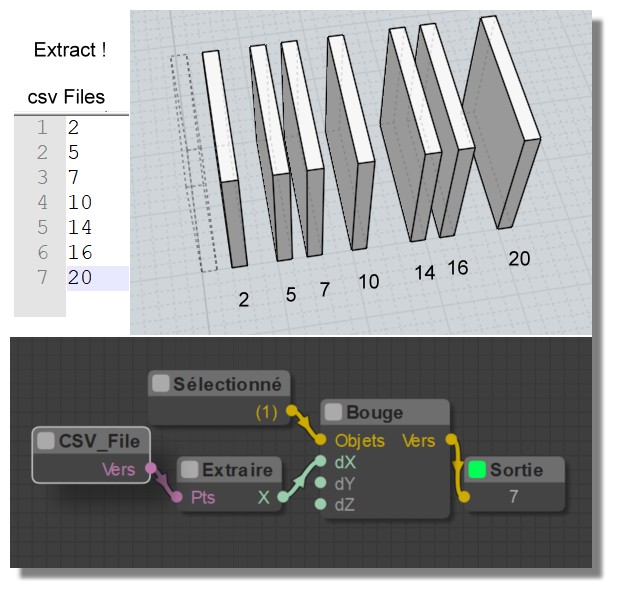

It was trivial but the node ExtractPts is not in the classic Elephant but in the "extention" : http://moi3d.com/forum/index.php?webtag=MOI&msg=9358.1
So we can take now any object(s)! :)
And any sort of gaps but by external tricks (Excel or similar spreadsheet)
...wished of course an internal one...but that is better than nothing! :)
Allways not found the generic "Box" if existing ???
so use here a selected before drawn one!
Extraire = ExtractPts
Bouge = Move, Sélectionné = Selected,
Objets = Objects, Vers = Out, Sortie = OutPut
next will be the "internal" random gap...without Excel...
...and of course random size of the boxes!
EDITED: 29 Jul 2019 by PILOU

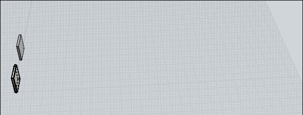

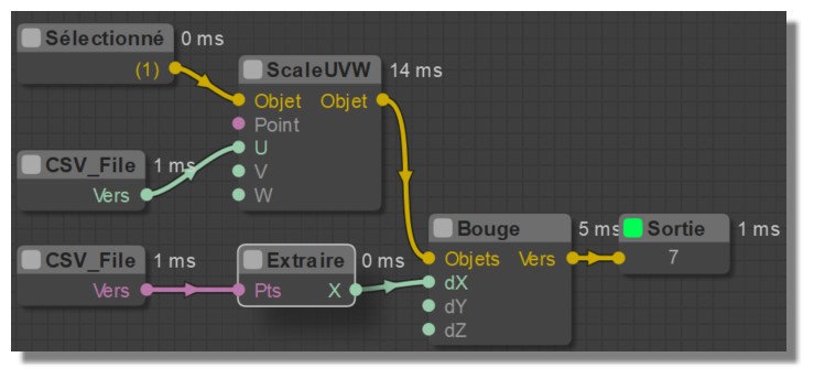

So I have the total control about size, gaps position for object(s) but with 2 external csv files!
So not yet that i want : the result is good but not the method wanted! :)
Seems node Scale has priority to the node Move!
(always a pity that a repository of nodes don't existing...for see how each node is working)
I surely make it in next months because it's pretty hard to random test each one by one... :)
Bouge = Move, Sélectionné = Selected, Extraire = Extract
Objets = Objects, Vers = Out, Nombre = Number, Sortie = OutPut

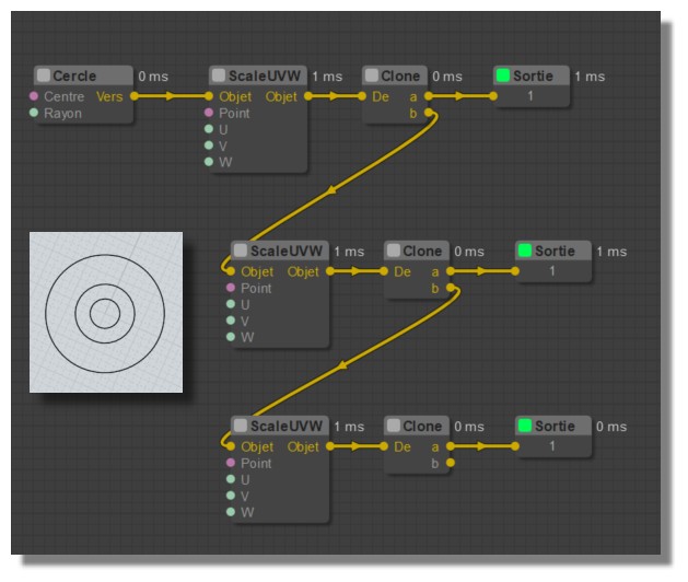

Does exist a "Loop" (?) for make "x" times the same thing ?
For avoid to write 100 times the same thing! :)
The Node "Box" (?) "Cube" (?) ... is always absent ?

Many nodes are multiprocessing, so in example of circle node, will take multiple inputs of radii
& output multiple circles.
7777.1593 In reply to 7777.1592
@ James Yes but write 100 constants or more are some painful! :)
I have seen that , does this "Loop" that I wish ?
