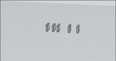

7777.1572
Hello
whith node random_obj i have this
For simulate different gaps: display random number of objects on their positions from a collection
Node random Obj is existing
not yet exactly that i wish :) the gaps 1 3 1 1 1 2 1 result must be on each object
but it's more like that i wish :)
A random gab between each object selected!
Classic Random
Move is existing
Display is existing
Not sure about the "one by one"...and the "loop / return"
Does this is possible ? A sort of random gab distribution between each object selected!
For make some variation of this follow where gabs are regular except on the front corner! ;)
https://rawandrendered.com/modularity
From a Camacho image above
EDITED: 22 Jul 2019 by PILOU

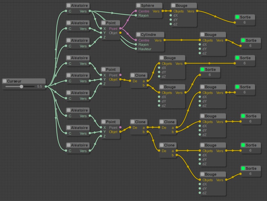

7777.1576
I have something but i must build each object...
so no loop...but a big graphic of nodes :)
A trivial question : how make the same than Clone for Object but for a simple value given by a cursor ?
(so given this value to different things...duplicate ..for avoid to move the cursor many times)
EDITED: 23 Jul 2019 by PILOU
7777.1577
I can play with general thickness and "one by one" placement
I wish only one cursor for the placement of all objects!
So wanted a node who deal with the numeric value of the cursor (surely existing...) and dispatch it after a treatment so multibranching...
http://moiscript.weebly.com/uploads/3/9/3/8/3938813/5_plaques.nod
7777.1578
PS No simple "Box" node ? I ha extruded a rectangle but...
7777.1579
I believe that i have found something as arborescence working! :)
Pink & pale green links can be multiple from the start!
Only one cursor, any numbers of objects with different regulates! (of course i must make each object after the cursor... )
but that will work! :) here only 2 volumes and Points for test...
Does it existing somewhere list of nodes with examples result ?
EDITED: 25 Jul 2019 by PILOU
