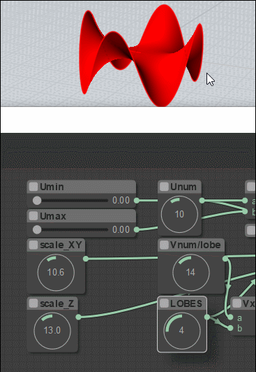

PS The attachment was a scrrenshot of the node which does not work because
as you said ""MathArray" was superseded by "MathsPts"

6521.34 In reply to 6521.33
Tom,
OK, I've added Umin and Umax sliders which should do what you want.
