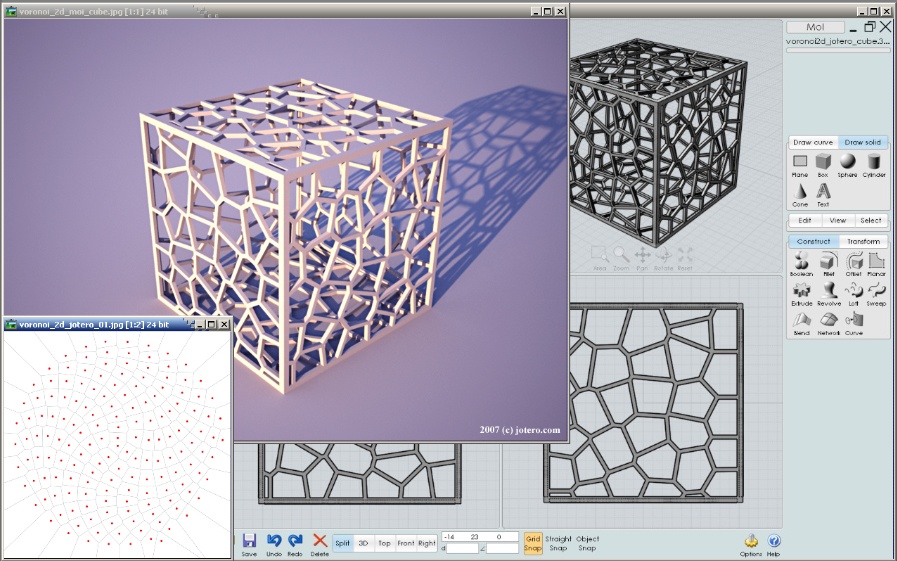

 From:  jotero (TOROLF)
539.42
hello all :)
voronoi 2d cube end ;)
ciao
torolf

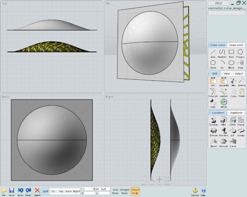

539.43 In reply to 539.42
Absolutly beautiful!
Any chance to see it at http://www.3dvia.com ?
What is the horizontal line on the middle of the object on the Moi Screen (Front, 3D) ?

 From:  Marcofly
539.45
Beautful models, Torolf!!! it's always surprising to see your creativity!
Did you use a program to create the voronoi diagrams?

539.46 In reply to 539.43
is from my collecting main. "Curve Project"

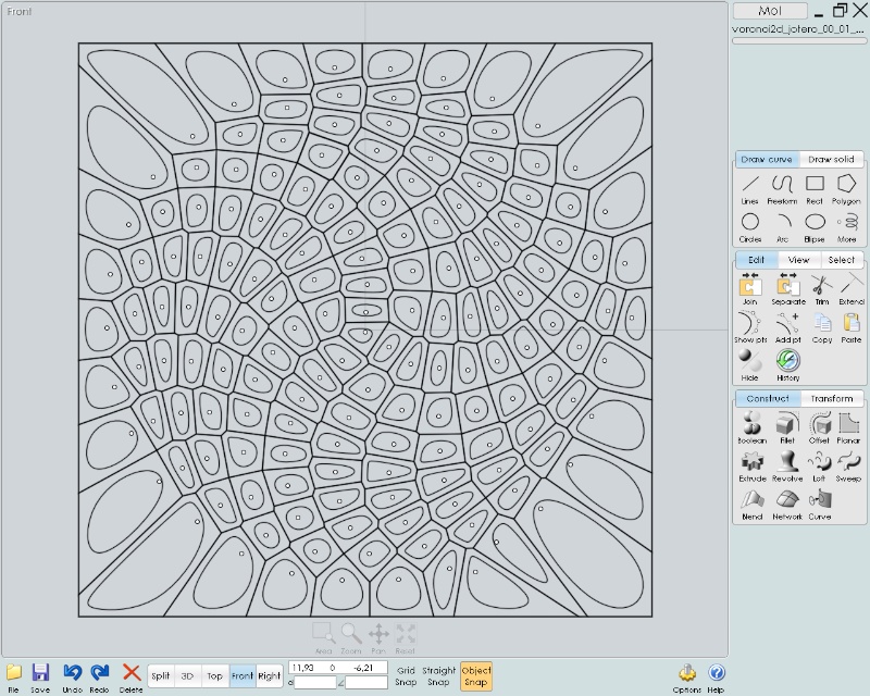

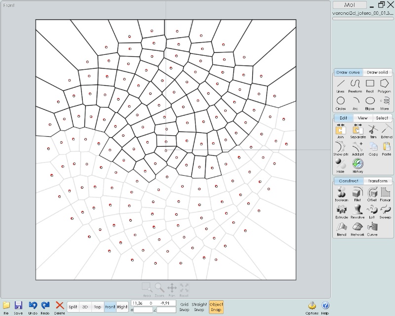

539.47 In reply to 539.38
Hello,
can everyone explain me the step from this one
to this one
With Offset I get not such round shapes. See the image and file below.
Thanx
Michael
539.48
maybe after the Offset
Select all internal curves
use Key Tab
then write Rebuild (Enter)
By Points 4 or more
With
Disable Keep corners
& Erase input Objects
EDITED: 19 Dec 2010 by PILOU

 From:  Apophis
539.50 In reply to 539.48
Pilou -I don't know this workaround.
Works fine, many thanks...
