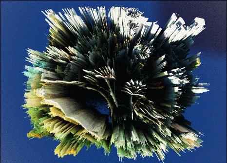

Winter-Spring (with my image from DesignSpark Mechanical! ;)
EDITED: 23 Jan 2019 by PILOU
4446.561 In reply to 4446.560
Beautiful!!
Pilou I have a little request... :)
If you want, could you generate some of this renderings with Magica, using one of the painting that I've done in Procreate (on iPad)?
If you can do it, I will sent you a PM with one of my paintings and you can post here your Magica results :)
If you cannot, no problem :)
Let me know. Thanks.
4446.562 In reply to 4446.561
No problem it's 30 second for reload something...and you navigate as you want inside "your" image! ;)
Send me anything you want! :)
But why you don't try to make that with Magica ? i have yet took all for that!
I can make a little resume if you want! :)

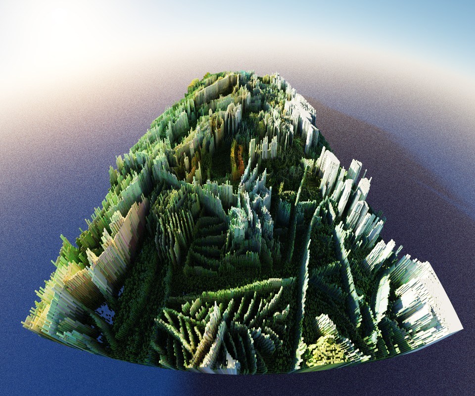

4446.563
MagicaVoxel installed
- Load somewhere the last version of SchematicToVox by Zarbuz : https://github.com/Zarbuz/SchematicToVox/releases
- put your image png 256 colors in the same folder (not obliged but more easy)
- Put the line following inside the command line of windows (Logo Window + R) (for Windows 10 without Pilou of course ;)
​C:\Users\Pilou\Downloads\SchematicToVox-v1.3.2\SchematicToVox.exe --i heightmap.png --o output --hm 100 --color an image
That all : an file output.vox is created : just reload it inside Magica and have fun exploration!
Ps for a Mac I prefere say nothing... because i don't know if the Schematictovox.exe works with this OS !
With an old image created with the incredible free Verve for valide that is writed above! :) (30 seconds all process)
White sun
