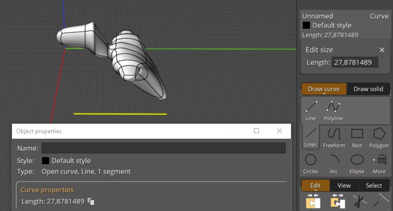

Hello Michael,
In the Options > General > Decimal Precision window, you can select seven decimal places.
However, in several windows, I cannot see all seven decimal places (see attached images). Is this a problem with my interface settings? Or a setting in the me.ini file? Or something else? I’ve done some research, but I haven’t found a solution.

Size: 33.6 KB, Downloaded: 2 times, Dimensions: 312x227px
Size: 62.5 KB, Downloaded: 1 time, Dimensions: 626x437px
Size: 30.9 KB, Downloaded: 0 times, Dimensions: 295x272px
Size: 58.9 KB, Downloaded: 3 times, Dimensions: 950x540px
12100.2
i believe that you can see them on the Up right side corner and Detail window...
And inside the Bottom Line numeric boxes input ! (not shown here)
