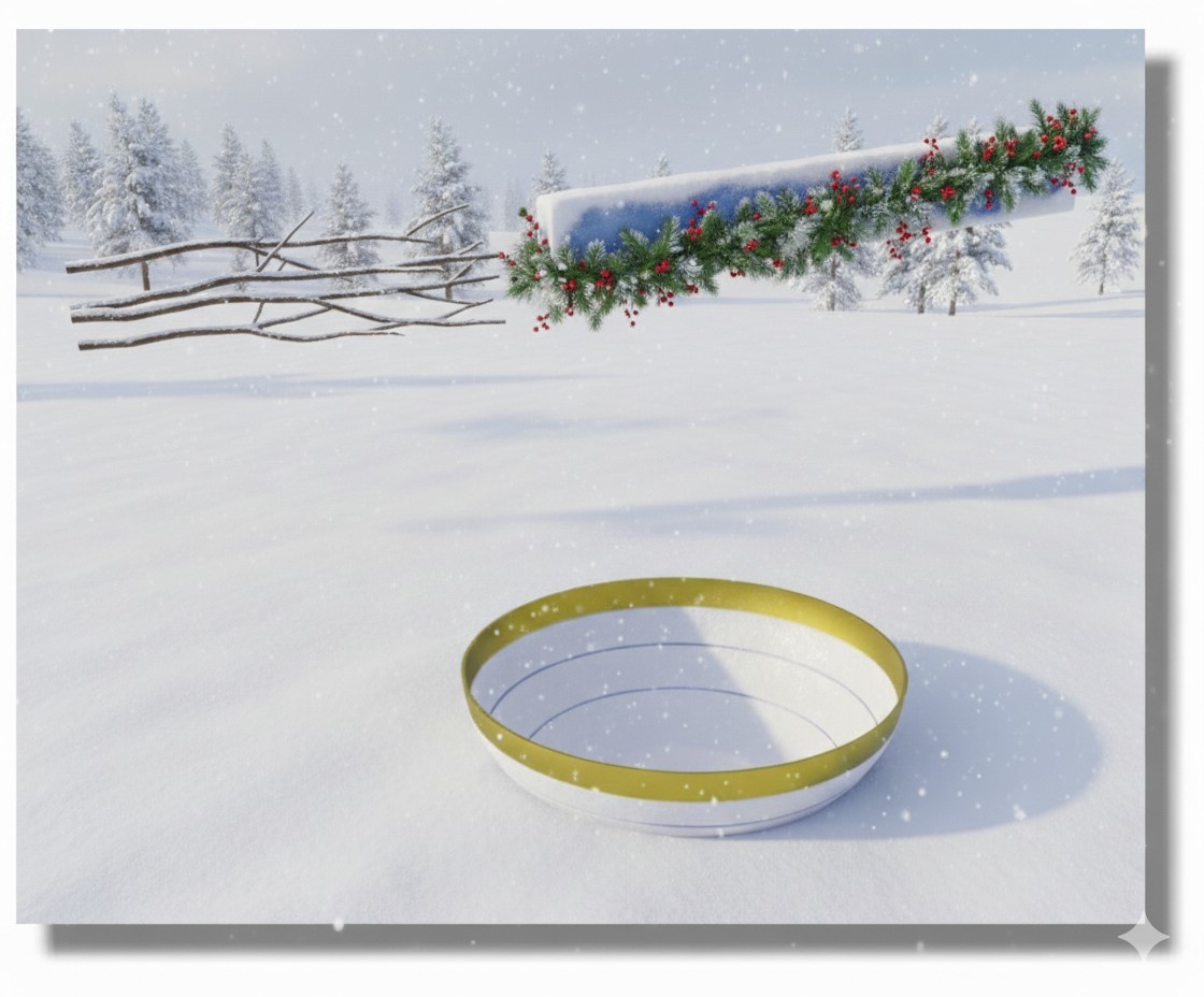

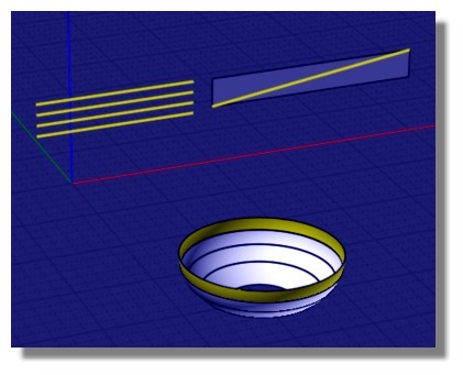

Here i take a diagonal of a rectangle
Then Flow it on any symmetric bowl ( because curriously project a curve don't works)
I had one turn!
So stack the bowls !
That must make the trick! ;)

11814.4 In reply to 11814.2
Thx. But I cannot follow your workflow.

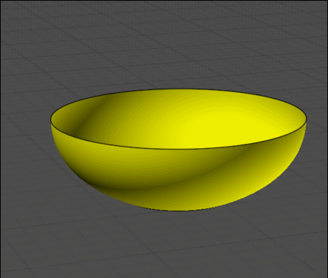

11814.5 In reply to 11814.1
see photo.
Barry
11814.6
About my not speed method :)
Sorry in fact you don't stack the bowls but you trim it horizontally!
Then Flow the diagonal of the rectangle on each slice bowl part :)
Not the helix following!
