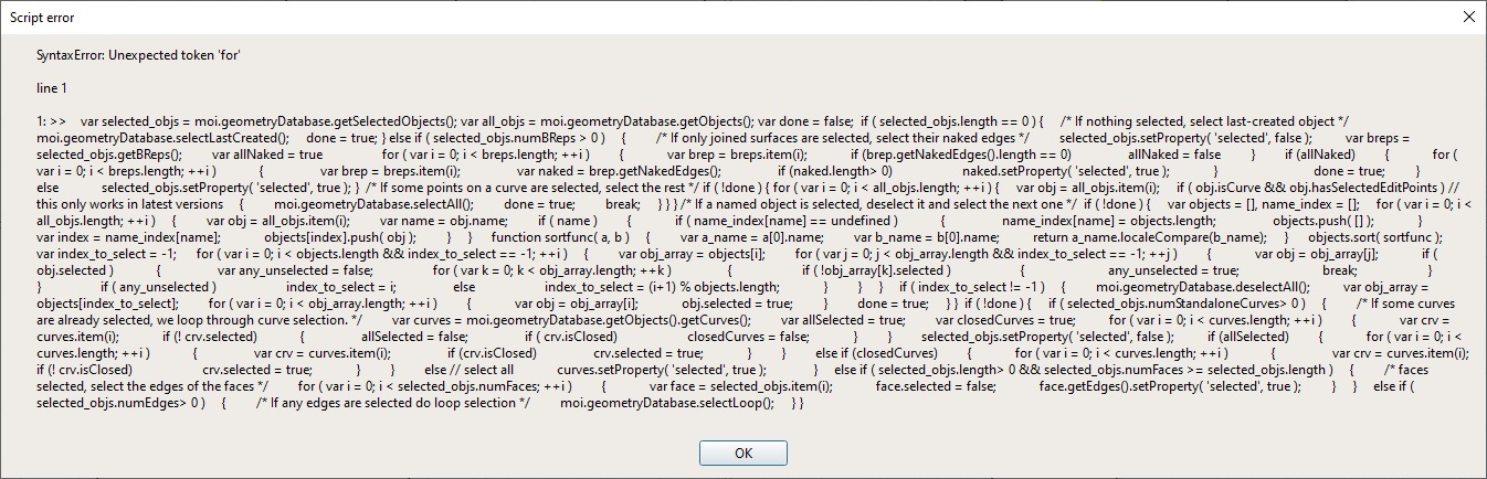

11127.22 In reply to 11127.21
I did what we usually do to assign a short key to MOI commands/scripts but I get this massive Error!
I want to have the effect you can see here: https://www.youtube.com/watch?v=9DBqE_CX7Zo (after 0:55 of the video you can see my desired effects; How can I have these? )
- Psygorn
