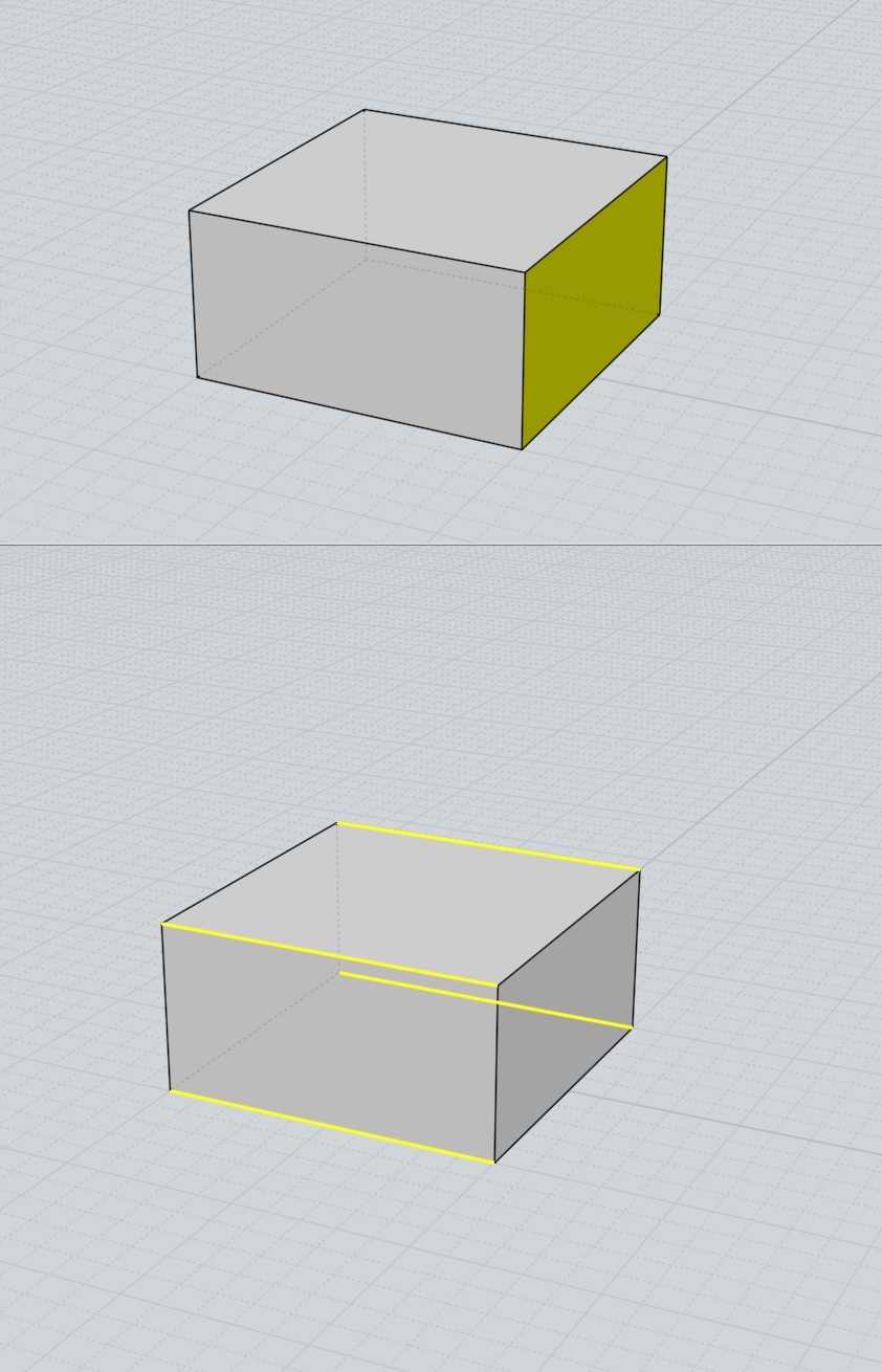

That's working ok for me over here. For example when I have this face of a box selected:
When triggering the script it results in this edge selection:
If you're not able to get that result, can you please post your moi.ini file so I can see if you've got the entire script in there? You can find your moi.ini file's location by going to Options > General > "Edit .ini file" button. A dialog will pop up and show you the location of the moi.ini file.

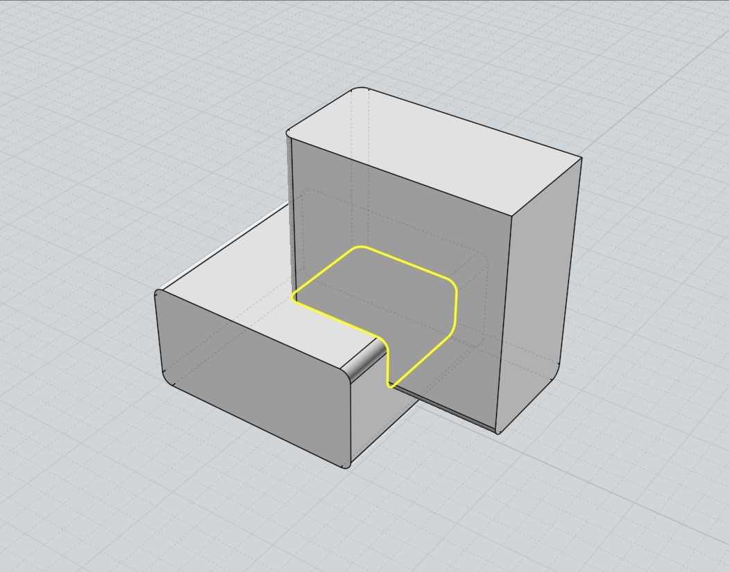

I want this effect:
and this one:
In a YouTube video which you can find it here: https://www.youtube.com/watch?v=9DBqE_CX7Zo it is mentioned in MOI V5 there are new features and from 00:55 seconds afterwards the above features are shown!
I saw the video and I thought I would want those features too. So, I reached out to you. :-)
- Psygorn
11127.27 In reply to 11127.26
Hi Psygorn, what you show there are not new features for MOI v5, they are features of some scripts that the person making those videos has made.
You'll need to reach out to them, those are not built in functions in MoI as of yet.
