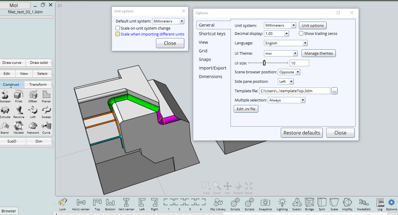

 From:  WN
10832.22 In reply to 10832.21
Hi Krass.
I switched to other units of measurement and here is the result.
image host
https://disk.yandex.ru/d/7bF1-_mvakjnWA
EDITED: 1 Sep 2022 by WN
 From:  krass
10832.23 In reply to 10832.22
Hmmm... Very, very interesting.
I'll try it now, thanks!
 From:  WN
10832.24
I was mistaken, most likely it is a small scale, zooming in, for example, as here in the picture, allows you to make rounding.
image host
 From:  WN
10832.25
In the original scale ...
imgbox
it turned out only such a maximum fillet ...
imgbox
