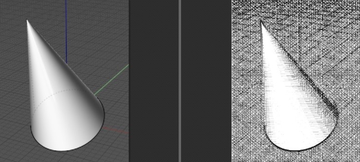

10774.31 In reply to 10774.30
Hi Pilou, that's too dense with too many lines crossing each other. It should only have 2 lines crossing each other at any single point like this:

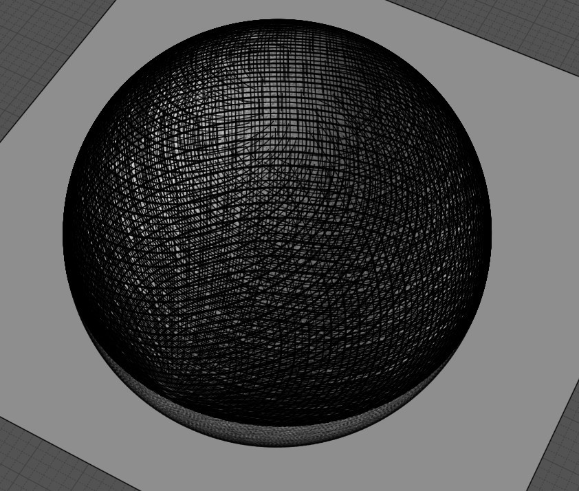

10774.36
Failed test
