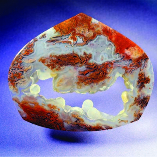

This link shows a side view of a cabochon:
https://www.rockngem.com/filling-an-empty-space-and-enhancing-a-cabochon/
I had thought that it is a sugarloaf, but now think it is a "slab" for a pendant. ?
Learned a new word: "vug"
https://en.wikipedia.org/wiki/Vug
image host
EDITED: 20 Apr 2022 by BEMFARMER
