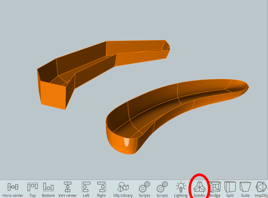

So a minimum of 3 different methods :)
10286.10 In reply to 10286.9
Well ... As long as we are counting Pilou :)
We have the SubD method. But not recommended for this application as the NURBs methods are more precise and easier to edit.
EDITED: 24 Apr 2021 by EDDYF
10286.11 In reply to 10286.10
The SubD method is the poetic method! :)
