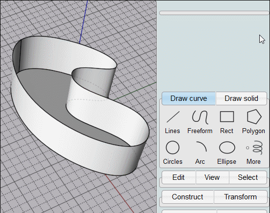

This is not the intention...
That´s the middle and ring finger of a hand. But I need a blendcap and the fingers are still two fingers...
How can I do this goal?
 From:  Lara (MALA)
10155.23
I also tried a concept with two splines. They are closed splines. BlendCap says: I do need closed splines to do the job.

10155.25 In reply to 10155.23
split finger curves in two then blend.

10155.26
For Blend something for have a surface(s) you must have yet some surface(s) to the curves selected!

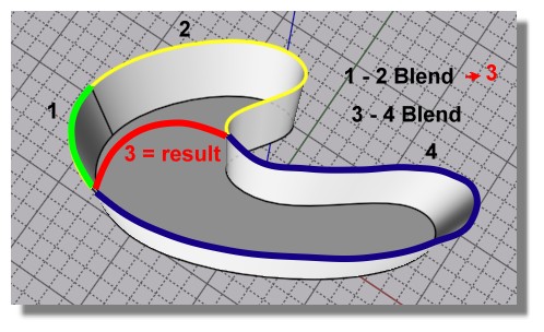

10155.28 In reply to 10155.27
Maybe like this ;) Blend is a magic function!
1- 4 --> 3 Blend
2 - 3 Blend
will give also another different valid result
4 - 2 Blend ->3
1 - 3 Blend
etc...
Order is important following result wanted!

 From:  Barry-H
10155.29 In reply to 10155.27
Hi DanC,
the finger shapes are extruded then the top edge of each finger are trimmed at the tips.
You can then blend one side of the finger to the other.
Hope this helps.
Barry

10155.33 In reply to 10155.32
That you maybe missed on the video is the line who "Trim" the perimeter...for have the 3 curves segments (1 2 4)
EDITED: 13 Feb 2021 by PILOU

10155.35 In reply to 10155.34
Like this you trim the top perimeter edge!
(carreful to kill a possible curve against the perimeter edge! )
Kill of course the line after the trimming...if necessary
PS the vertical line is the Curve generator (made during the extrude ) so automatic trimming! :)
You can now make your Blends!

 From:  Barry-H
10155.38 In reply to 10155.37
Hi Lara,
Use blend NOT blend cap.
Barry
