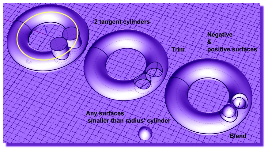

10120.47 In reply to 10120.46
It's not the shape because above Bases of form Up & Down are not tangent to the Tore!
I will see if that will match! :) (when i will have 5 minutes)

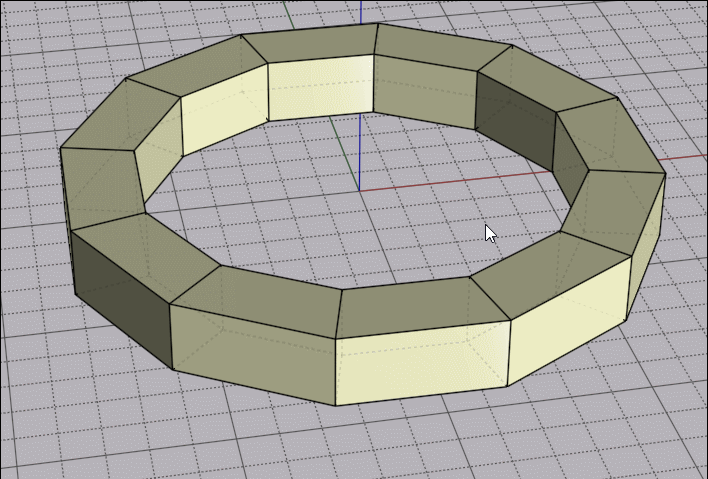

10120.48
The Blend function is fun but effectively that will not done exactly obtain that you want :)
Maybe the SUBD like shown by Burrman is another possible way... :)
Thread about SUBD : https://moi3d.com/forum/index.php?webtag=MOI&msg=9689.1
Several faces can be Subdivided in the same time with the same dimension! (here just 2 faces - Up Down one by one)
