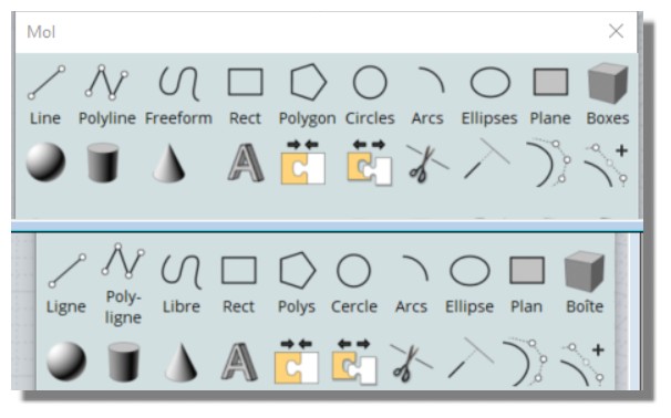

> I try to make the first line (10 icons)... French /English but not total success! :)
> Some stay empty!
> I don't believe i had made some type errors ???
There's a few things - it would be good to have a close tag on the <moi:Text> elements, that could be either <moi:Text textid=""></moi:Text> or a shortcut way is <moi:Text textid=""/>
Also since the <moi:Text> element will have text inserted inside it, you don't want additional text in there next to it, it probably happened to work because with the missing close tag your extra text was a child of the <moi:Text> and got replaced when it inserted its looked-up text content.
Last thing is the textid="" attribute must exactly match a name in the Strings.txt file including upper/lower case. So for example you have textid="PolyLine" but the name of that entry in the strings.txt files is actually Polyline= . Because you have different capitalization it won't find it.
So for polyline you would want this:
code:
<td><moi:CommandButton icon="icons/PolylineIcon.png" command="polyline"><moi:Text textid="Polyline"/></moi:CommandButton></td>

Your modifications do not quite follow Michael's posts. You have incorporated the French names, in addition to the English names.
Delete your French names, and the resulting names are looked up.
If your language is set to French, (in options tab), the French names appear.
With language set to English, English names appear.
I've changed a few, so am not done...:-)
Will see if any more problems appear.
I see Michael posted first. Yeah I'm missing Polyline. Also Freeform not FreeForm. :-)
It is Polygon, not Polygons...
I do not see Helix and Conic...
The plural of menu is menus, in English.
Looks like it is menues in French :-)
Thanks for the additional infos! I will see if that works better :)
@ Beam :it's Menus in French ;)
Menue is existing too but it adjective for woman (Menu for man, Menues for women, Menus for men) like slim, thin, mince
Much better! All is quasi perfect
except for the last four Arc, Ellipse Plane "Boxes" who stay in English like the French "Boîtes" ???

I think, you don't have to add names.
The id give wich label have to be seen, function of the langage.
En french...
Il ne faut pas mettre le titre de l'icone "en dur" dans le fichier, c'est l'ID qui indique au logiciel quelle titre il faut écrire et qui met le bon titre dans la bonne langue en fonction du paramètre de langue.
Comme c'est écrit dans l'exemple...
<moi:CommandButton icon="moi://ui/icons/LineIcon.png" command="line"><moi:Text textid="Line"></moi:CommandButton>
Le texte du textid=Line sera Line en anglais et Ligne en français et c'est le logiciel qui le placera automatiquement en fonction du paramètre de langage.
Hi Pilou, the bold text you show above there should be removed, it will be extra in addition to the <moi:Text> that is right next to it.
For those <moi:Text> that are not working, look in EnglishStrings.txt and do a search for the textid value that you are using.
For textid="Ellipses", if you search in EnglishStrings.txt you won't find any line for Ellipses=, but there is one for Ellipse without ending "s".
Same for Planes (should be "Plane") and Boxes (use "Box").
